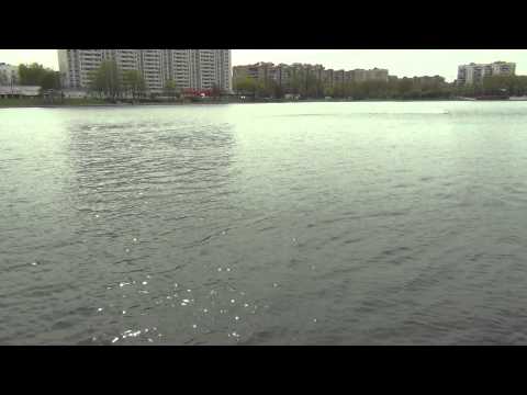

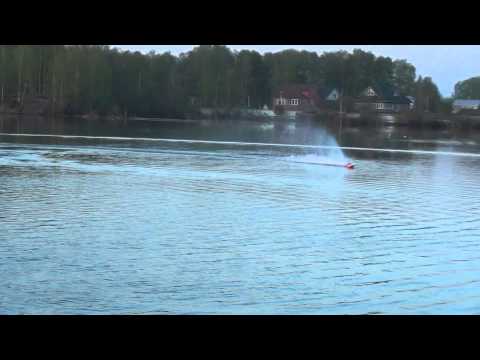

          Hi to all! At the last summer i was crash boat motor. Today i have first run at the new one. TP power 4060 1400 kv PRO series.
          what do you think about this?
          It has some problems with boat stability, i will fix it.
            • 7651
            #80
            I'm going to say maybe add just a touch of trim tab Cyber. And then give some nice full runs and not so much off and on. It is hard to tell temps too with all the off/on.
            But it is looking good.

                Yes, you right. I has full run at the second complect of accs, it was end with crush :) Boat was turn to the left board each time than it up from the water. It can be from the differend weight at the left and right board. Next tests will give me more information.

                  new video of my boat, very nice run for me

                    Dude that's a good run for anyone. Nice job!

                      Beauty job Cyber. Excellent

                        It's not bad but it still looks like it's running a little wet. On the strait WFO passes, I saw spray coming from about 2/3 of the way up the hull..
                          you are right. i will try to fix it with stinger configuration, but don't sure that is possible.
