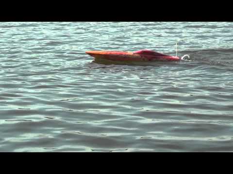

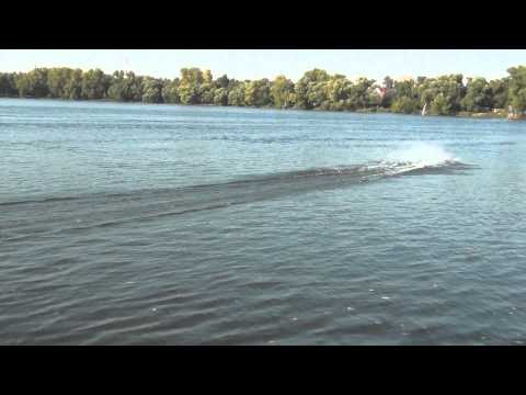

        I think you're running your boat wet

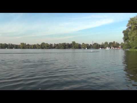

          Test
          Test : http://youtu.be/t35JVU7haFA

            With Flier ESC.
            Battery - 60 degrees,
            Motor - 50 degrees,
            ESC - 30 degrees

                Battery temp is way to high. Max temperature is around 50°C. Any hotter will damage your lipo's.
                Boat is also running a little bit wet. Running your boat with less hull in the water will be beter for
                your current draw and will extend the lifetime of your lipo's.
                  Regards,
                  Roy
                  Thank you, i know this things. This motor is some weakness for this boat. It was work at the maximum of his opportunity. Today motor was failed. Next spring i will buy new TP 4060 4Y.
                  Maximum speed of all runs is now 92 km/h

                    So which prop do you have on there in that run. My DF would ride like that with a prop with too much pitch.

                      There is a reason why you burn of your esc and your motor failed you now. I would really change your cg and run your
                      boat not so wet because even a completely knew motor will fail in time if you keep it running like this.

                          A TP4070 is overkill in a skinny racemaster. I know people who get 80-90km/h out of a racemaster with just a TP3040 on 6s. Those boats
                          are running loose and you get 5min of runtime out of a 5000 6s 40C Zippy lipo. Just search for some other racemasters on youtube. You will
                          see, a racemaster shouldn't run that wet. MHZ recommends a lehner 1950 for a racemaster. A lehner 1950 is also just 36mm in diameter
                          and 74mm in lenght. You can get up to 100km/h with that tiny lehner if your boat runs correctly. Think twice, you can put more, and more,
                          and more power in you boat, but in the end, will that be the solution for the problems you have (hot lipo's, burned esc, broken motor)?

                            Octura X645 prop.

                                I don't see any single motor racemaster, what runs more than 90 km/h at youtube. Some boats with lesser motor and lesser prop was run 60-75 km/h, but it's to small for me.
                                I have an idea about power problems this boat, it is a big prop. I think about 43-44 with 1,5 or 1,6 pitch. I can't find any of this at this season. Next spring i will find some props for the tests and will complete this boat at the 90-100 km/h with normal temperatures.
                                I have a question about running boat wet. Wha can i do to solve this problem? I was try a some stinger configuration, i was try a some battery position. But i can't up the hull from the water.
