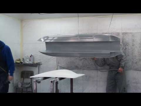

Painting...MHZ Mystic 1850...
On the photos is Mario, a professional car painter...he worked for years for Nissan service center
VIDEO OF PAINTING SESSION IS COMING SOON
Sanding of the whole hull took almost two hours...
DSC07101.JPG DSC07110.JPG DSC07123.JPG DSC07123-001.JPG DSC07132.JPGComment
Production mistakes are fixed with putty, dried and sanded again...
DSC07146.JPG DSC07144.JPG DSC07150.JPG DSC07154.JPG DSC07157.JPGComment
In a ventilated and heated painting chamber...
Ready for two layers of PRIMER coat, with corrections between layers
Primer coat applyed...
DSC07166.JPG DSC07167.JPG DSC07169.JPGComment
