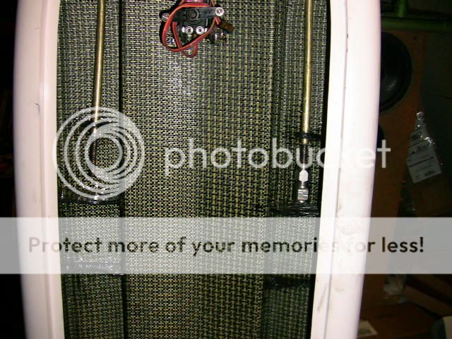

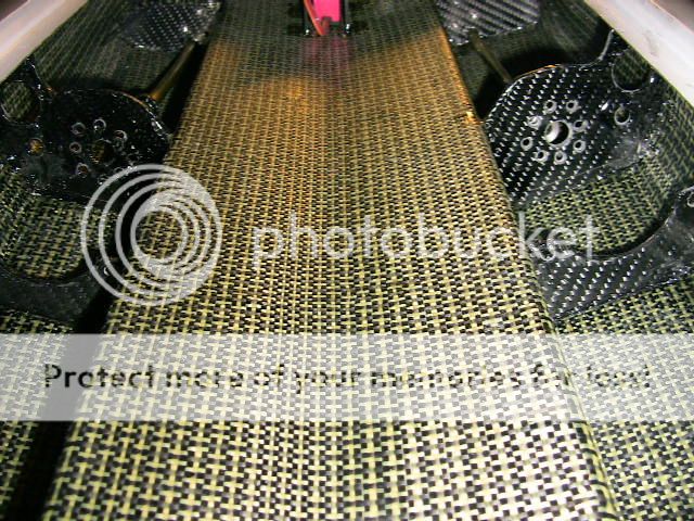

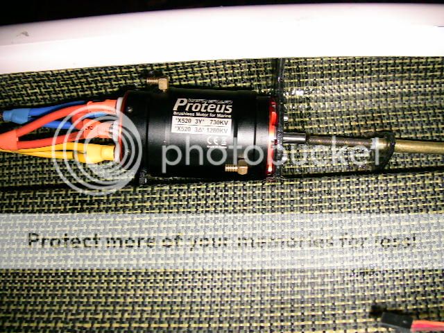

                Thanks guys for the advice, but I am already sure I won't do any rear support for Lehners.
                I have used double motor mounts epoxied together and I am pretty confident that will do. I believe it is better than it is needed. I can take the motor screwed for the motor mount in my hand and lift the whole boat that way.
                We'll see :)

                  The rear mounts won't be the problem, the motor case around the shaft bearing might be. I have recorded 4 G's in rough water. That's a lot of overhung bending on the Alum. motor case at the bearing over and over and over and over.
                  • Yamadori
                    • Apr 2012
                    • 137
                    #99
                    Ok. We'll see. I am ready to try. Those Lehners are such a fat piece of aluminum that I cannot imagine something could bend it in any way

                              Where did you gather the idea of people running their props outward? Was it perhaps from I/C boats? The gas-powered guys spin them that way because they have to direct the exhaust out the side of the motor that faces inward. They can only change direction by swapping motors, which would aim the exhaust straight into the side of the hull. I'm much more familiar with electric than gas, so this could be all lies, but I think it's true.
                              Rear motor mounts are not necessary if the main plate is strong, I've ran large motors in a boat this size without rear mounts. They are however beneficial in a hard crash. Consider that in a hard crash, even if the mount doesn't come loose, the force can try to push the mount through the hull, and it can/will damage the hull in some cases. Even with the strongest motor mounts you still have a fulcrum and lever effect if the boat lands hard and suddenly stops upside-down, backward, etc. Having the motor mounted in two spots (front/rear) can help, but of course nothing is truly bulletproof. For the kind of running that you will be doing with this boat (I've watched your incredibly well-shot and edited videos!), you will likely never experience anything of concern.
                              The rear supports that someone else posted in this thread would do very little without the motors actually attached to the mounts, other than to help overcome the force of gravity while the boat is sitting on the shelf.
