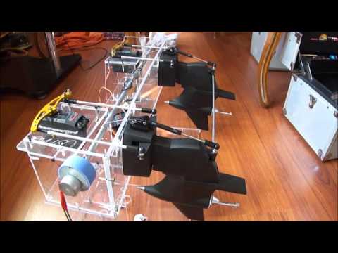

Looking on google. I found this video. http://www.youtube.com/watch?v=SVcVX9-l_WU
Has any one used this set up brushless?Last edited by twissted; 02-05-2013, 10:33 PM.twissted from speed. Lead, fallow or get out of the way. Copy cats in back of the buss!!!Comment

The way this drive sytem is set up it would take a big boat to keep it scale. Something like the Centralrchobbie 70" Outerlimit SV. I wonder if they would stand up to a brushless motor.
