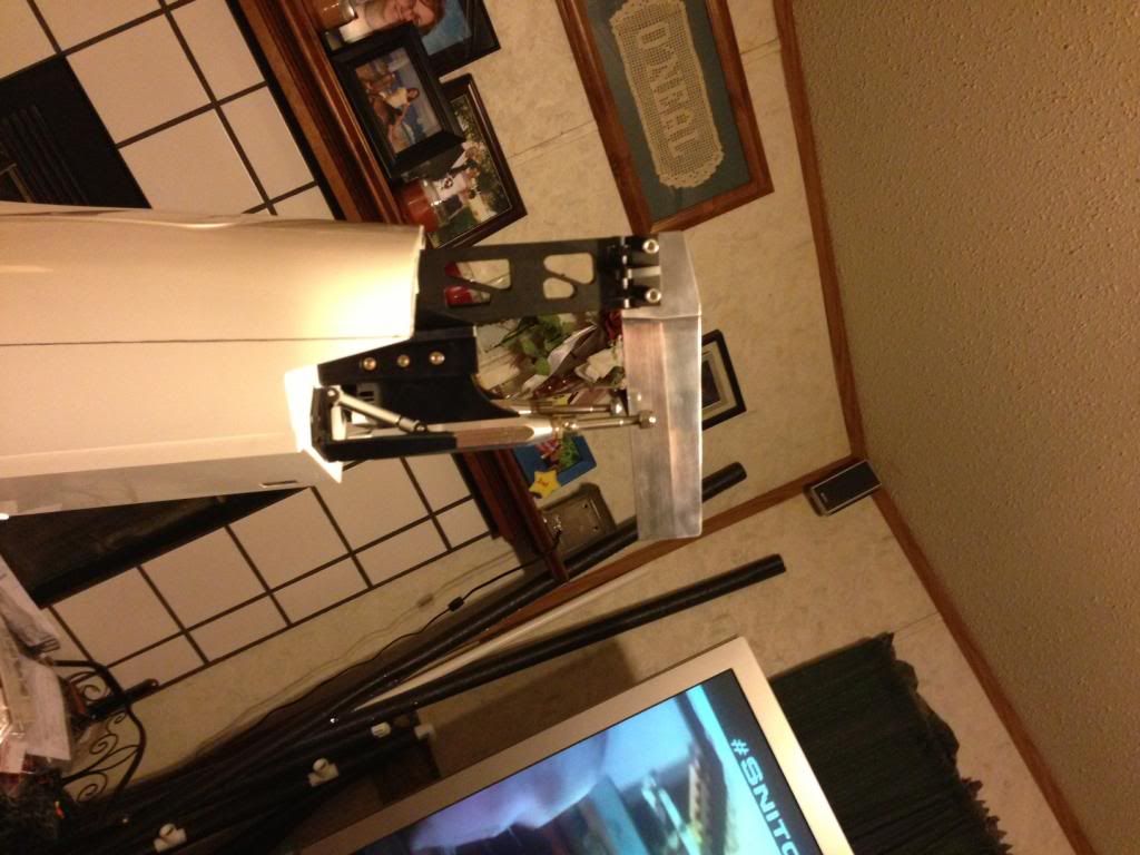

                  Trying to get some of your guys opinions on my hardware placement. This is my first full build, and just trying to get all the info I can before I drill the hull.
                  So far with talking to some guys on another forum, I'm going to move my trim tabs down closer to the bottom of the hull. Right now I have them 3mm from the bottom. I'm going to move the to 2mm up. Plus the leading edge of the trim tab thats closest to the drive. I'm going to move the tabs out on the hull till the bottom edge of the tabs, start at the center line of the drive shaft.
                  Let me know what you guys think. Since this is my first mono, and it is my first full build. Any and all comments are helpful.
                  Here is the transom with the placement.

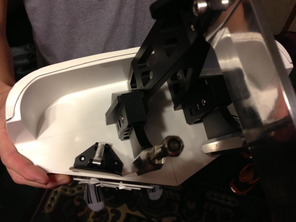

                    And some more, the parts are just held on with double sided tape.
                    Plus does anyone know where to get blue anodized trim washers for like these
