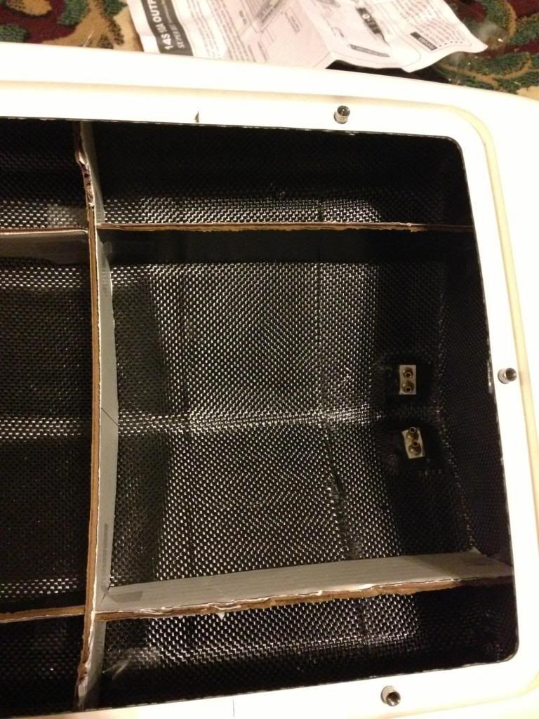

                          I'm kinda thinking out loud today, and decided to cut up some card board. Now you'll have to use your imagination with this. Cause all these pic's are of cut outs.
                          First off is the motor mount & the rear stingers that are at 7" apart. That will tie in the motor mount to the rear transom. Plus I don't show it, but I was also thinking of taking a 1 1/2" CF tube about 5" long. And cut it down the middle and epoxy it to the floor. So it makes a tunnel for all the water line and other wires to run thru. To keep it clean.
                          Next up is the same 7" stinger width in the motor/esc area. And there is a cut out in the bottom of the stinger for the water lines & esc wires to pass thru.
                          And the stingers keep going on towards the front of the boat another 15" to tie into another bulk head. Plus I was thinking of placing a plate between the rails. Where it would be like a battery box. CF plate on all 4 sides, and a bottom plate so I could strap the batteries down. And try to figure out a way for a top plate to the battery box. Where the batteries won't move around during a crash.

                            And in these next 4 photos. I was thinking of a peice of CF plate that would go all the way from the transom to the forward bulk head. Plus tie the stingers into the side of the hull. And in the pictures, where I have the ESC placed. I would cut out the CF plate where the wires will pass thru the plate. Where the esc would mount flat. And its a tight fit.
                            There will be an area 6-8" around the esc that will be removable. Plus back where the RX/Servo is will also be removible.
                            These are just ideas. Not set on anything yet.
