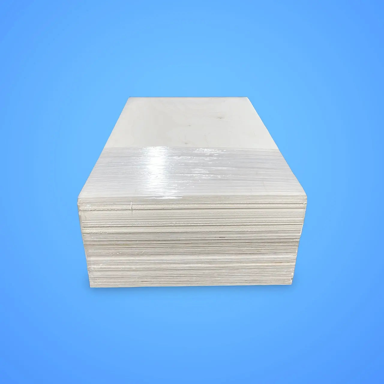

These people have verygood prices on plywood. I ordered a few 12"x48" sheets of various thickneses. Free shipping if you order over $150.00 worth. It will be shipped in cardboad box resembling a firearm box. Wood quality is verygood
National Balsa is a great choice for all your Plywood needs. All our Plywood is premium model grade quality wood. We offer Baltic Birch and Italian Poplar Lite Plywood. Our plywood comes in the thicknesses of 1/64, 1/32, 1/16, 3/32, 1/8, 3/16, 1/4, 3/8 and 1/2 and the convenient lengths of 12", 24" and 48".Last edited by detox; 02-06-2012, 09:31 PM.Comment
