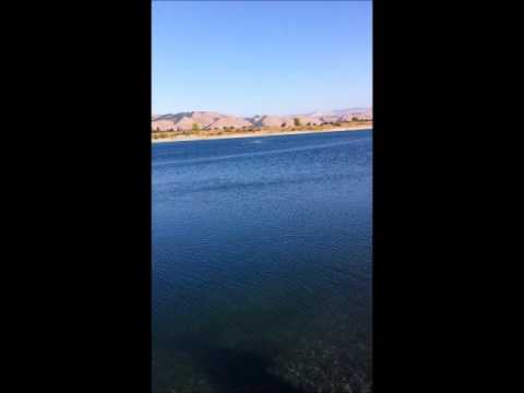

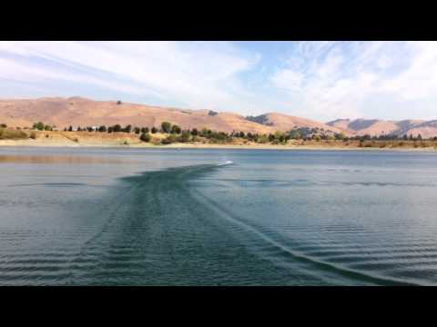

yeah if you read the above post that is just about where i was with the batteries all the way at the back now with them up front it comes over the wakes like it is glued to the water. do remember i have a 1480KV motor not a 1600 so that is why i am useing a 220 and for 2 minutes a X642. i have got to post some videos, i wonder if both of my GPS's dont get up to speed before i have to let off. they are the same brand.Comment

Boy that thing is running very wet.Comment
