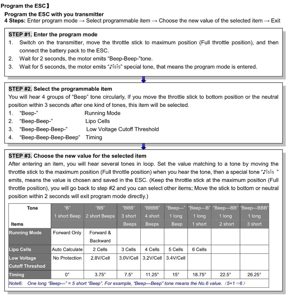

            Couple questions....
            I would like to program the ESC to lock out reverse. The Voracity manual says that this can be done with the transmitter and to refer to the DYNM3875 ESC manual. The ESC manual only says that this programing can be done with the programing card. Does anyone know the procedure for programing with the transmitter or if it's possible?
            Both the ESC manual and the Voracity manual say that the motor should get the cooling water first, then pass it to the ESC and then out of the boat. My boat came set up to cool the ESC first and then the motor. Which way is best?

              #201
              Tx programming instructions below.
              We must have missed the cooling instructions during the manual proofing. Looks like they used the same template as the Impulse 31. On this boat, keep the lines going to the ESC first. On the Impulse 31, it doesn't matter.

                            #208
                            Great info! Thanks guys and thank you Rafael for the instructions. I'll have to try shifting my batteries forward a little..... Ran the boat again just now and had a blast.
