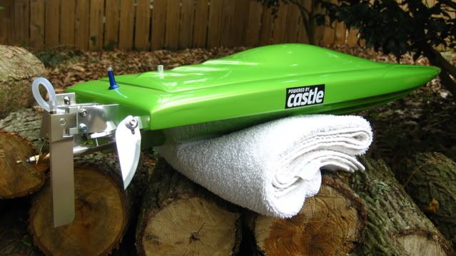

        Here's some sweet Toxic green I done that was used just from a can..
        Then cleared..all in all it will usually cost me $85.00-100.00 a hull for paint but always does pretty nice.

          Nice paint.....I'd like a metallic sparkle blue color. Did u sand and prime it? Kinds paint?
          • nate
            • 1652
            2 Coats of Valspar Grey primer, light sand soft grit, then the base green which is by Killer cans Alsa inc. then 2 coats of clear...then wax and boom done!
