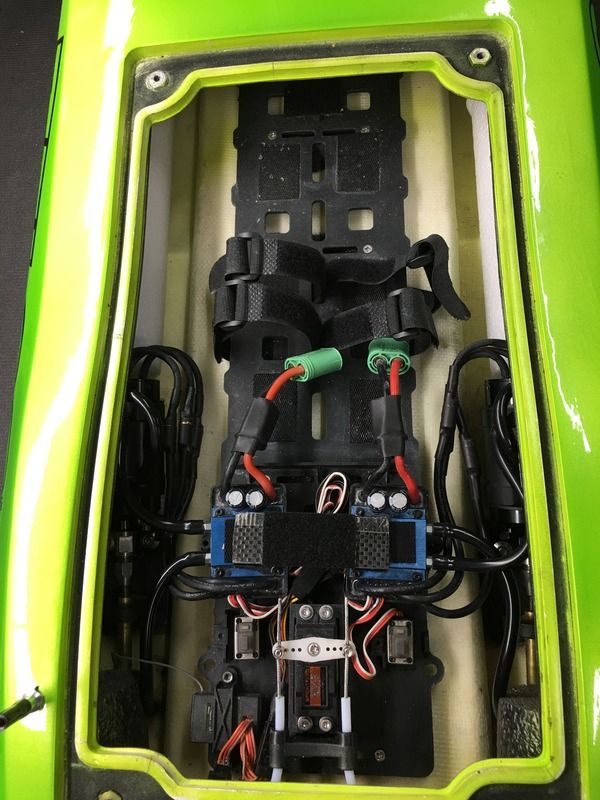

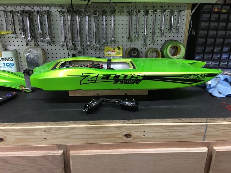

          So I had a little free time tonight. Finally installed the new motors. If I can I'll go run it this weekend and see if I can better my 76mph best.
          Can't really even see them

            Travis, what size and KV are those motors? What props are you running?

              1980kv for 6s. I'm going to run a 4400mah 6s pack per motor. ABC 1814-17-45 props. Should break 80 pretty easy. Maybe faster but I don't want to count my chickens before they hatch. I've actually gone 102 with less rpm than this. Tp power 4050 motors.

                      Oh My! Are those ESCs from the 48?
                        #1586
                        Heck no, those are stock lol. I'm trying to do things one at a time to see how fast I can go with minimal mods.

                          Lol, I guess with the all the black and velcro it kinda threw me off. By the way, your kit was delivered to my family. I should have it in my possession next weekend. Thanks!
