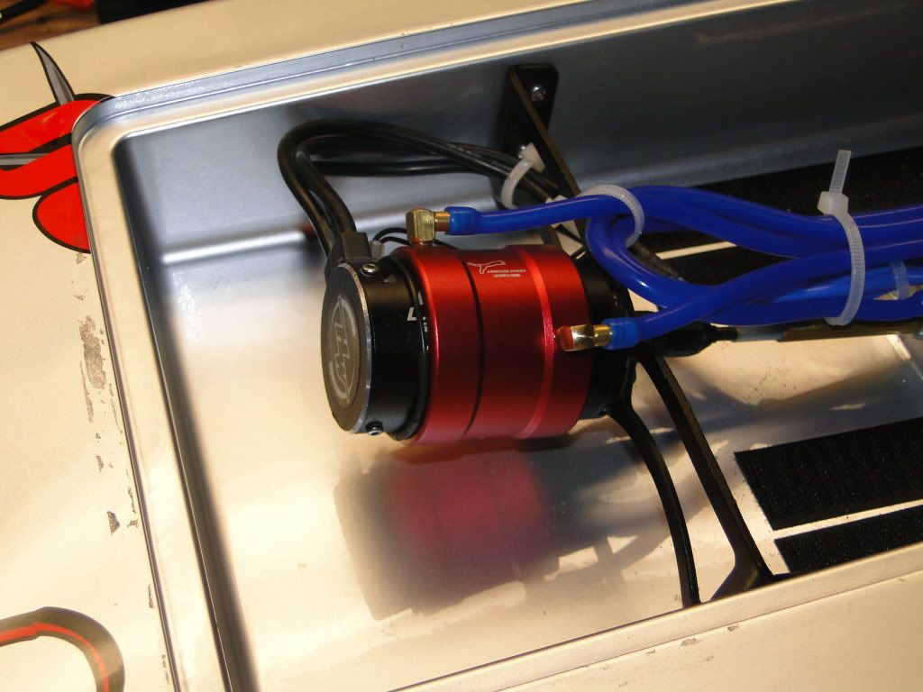

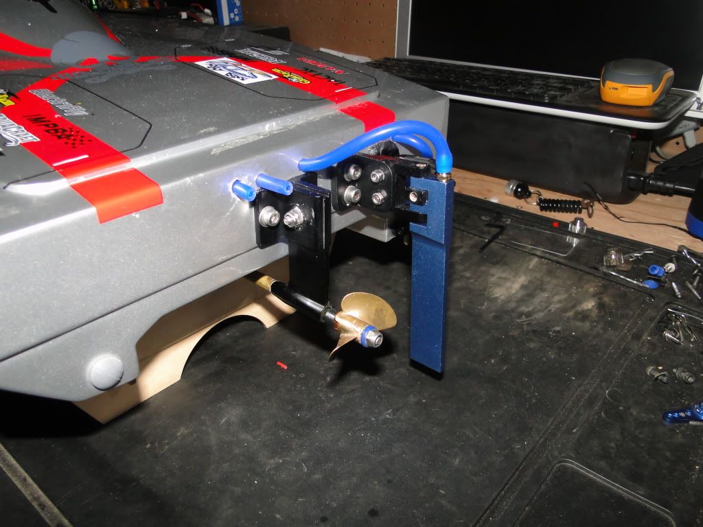

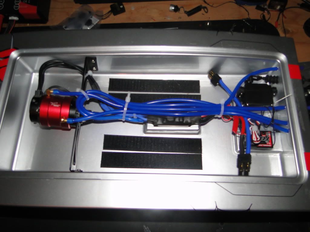

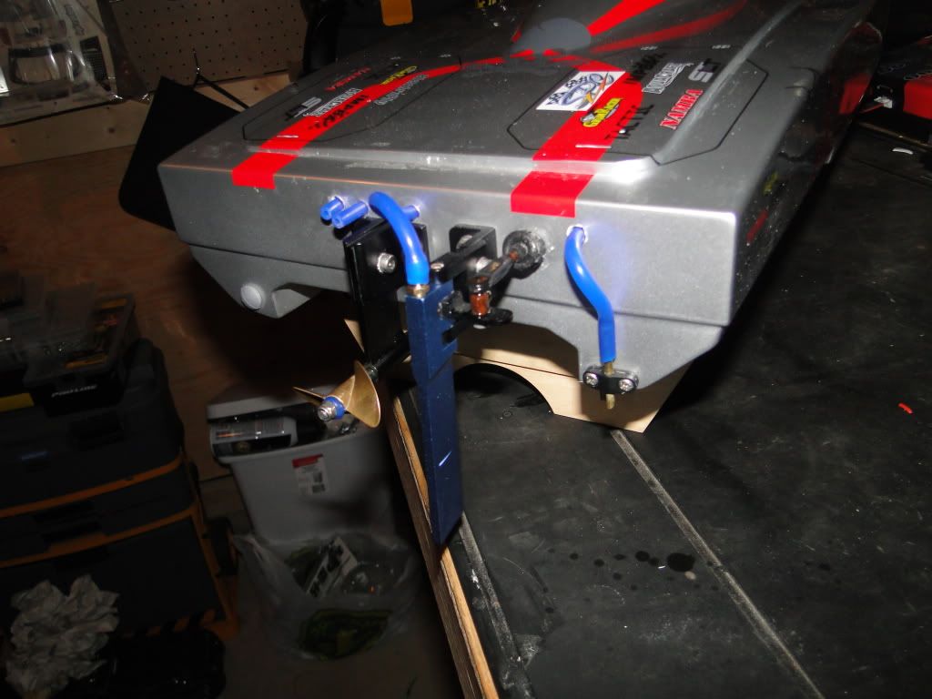

                        Man, where were you when I was trying to set up my boat. This is EXACTLY the info I had been looking for all along. It confirms what id done anyway but knowing what direction changes will take the boat is SO helpful.
                        I finally got the boat back home. (it was in my parents trailer while they were on holidays, they got home tonight) and I installed my Turnigy 120amp ESC and got it setup with my Traxxas TQI radio. I also installed the temp and voltage sensor the LINK app on my iPhone. It works pretty slick. Shows exactly how much voltage my 2 packs have combined. I can set alarms to go off at certain points as well and at multiple levels. Which is good because the highest I can set the LVC on the Turnigy ESC is 3.4VPC.
                        I also decided to TRY another motor I have here. Its an EZrun 4068 series 2700kv 4 pole. Its a big motor compared to the stock 36mm motor that comes in the MC. I have a Lepoard water jacket on it... I'm going to run it tomorrow and see how it does. If the boat runs like crap or if its just not right ill go back to the stock motor as I really had no complaints about it. I just thought id try this one for fun.
                        I also installed an SV27 rudder with the extra water pickup. So, I now cool the ESC from the stock pickup and the motor from the rudder... or the other way around... I can remember. Here are the pics just for fun.
                        Its alot of water line... but the way the Turnigy ESC has its cooling inlet and outlet (on the same side) there really weren't alot of options. I think its an O.K. job of cleaning it up but will having alot of line cause any issues with cooling? Do you think having double pickups will help keep things cooler than a single pickup?

                          Looks like you have no space between drive dog and strut? I like the dual cooling, if an inlet gets blocked at least only one component overheats, not both. What's the blue thing in front of prop nut?

                            Xland looks to be right.. you need to move the shaft back..
                            Also..all that money spent, motor, controller, whatnot and the prop has not been sharpend....
                            Might want to sharpen that prop.

                              I tried to buy a sharpened prop... but couldn't find one in stock with shipping to canada. Ive never done it before and didnt want to screw it up. I know to do it right I need a balancer as well. So I'm on the lookout for one. The prop and rudder need to be sharpened... I know
                              The drivedog/strut spacing is all an optical illusion. Theres about 1/8... maybe a bit more between them. In the pic it just looks like there isnt. Is that too much.
                              The ESC I bought just for the LVC... but the motor was one I just had laying around I think I have less than $20 into it and $10 into the water jacket. Figured id try it. If its not ideal ill go back to the stock one. This motor is 1/3 high KV than stock so I have to think there will be some sort of cause VS effect with that drastic a jump. I could run it on 3S and STILL get higher RPM (theoretical of course) than the stock motor on 4S. Would there be any benefit to that or will it not work or translate the way I'm thinking?
