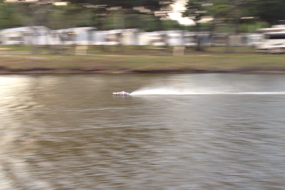

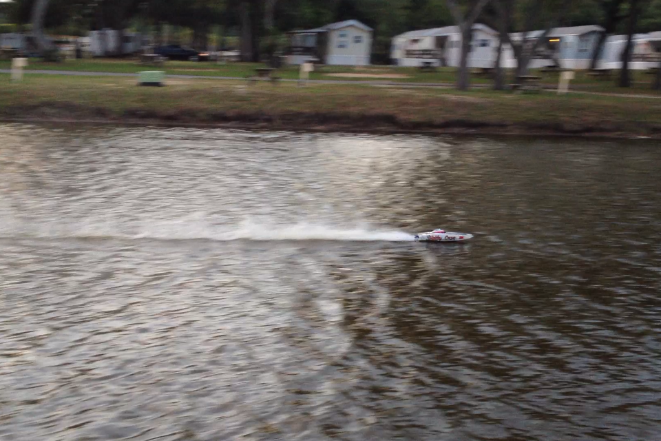

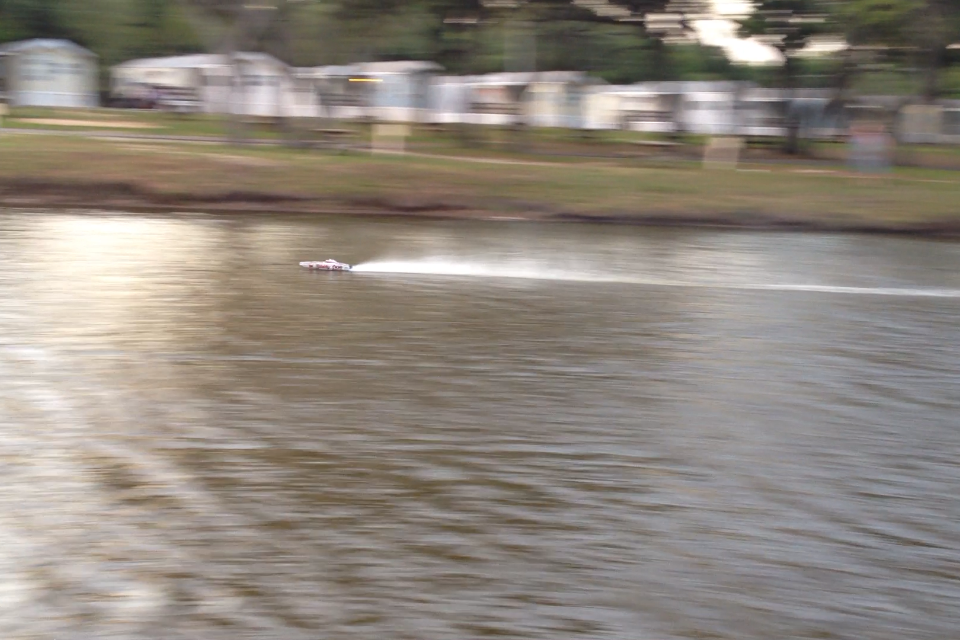

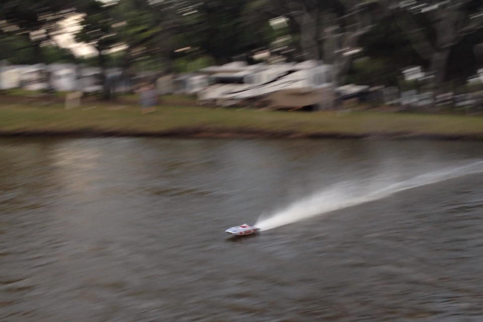

            Its at a trailer park on the beach called Pirateland. The people there seem to LOVE electric boats but anything with a gas motor would be too much for them. Im uploading a video to youtube right now and will post here once its done. You can get a feel for the size of the pond. Perfect for a 30 inch cat for sure. Id have 10-15 people "spectating" every run. I ran twice a day minimum, most days I got through 4 sets of packs. Only one flip that ended with the boat upside down. Sat on the shore for about 10 minutes while the boat floated to me, flipped it back over and kept going. This boat is sweet.
            heres some pics. They are screen caps from the video I'm uploading so the quality is pretty bad. But they have a nice action feel to them. As you can see, the boat is running VERY dry now. I have an SV27 rudder to go on so I can run both water pickups. I also have the Turnigy 120amp ESC to go in it. Unfortunately, the boat had to stay in myrtle beach at my parents trailer till they bring it home in about 3 weeks. So, till then, ill just be remembering the good times.

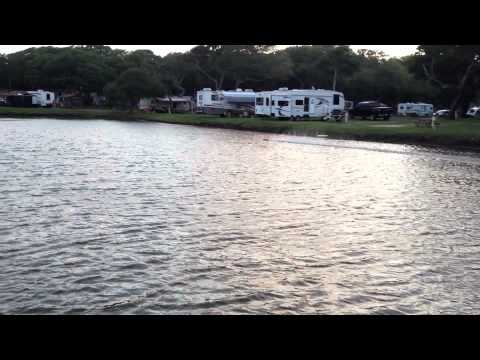

              Heres the video I took on holidays.

                Looks like it's running pretty good I am tring to get my MC dialed and and wonder if you can help me.I put my boat on a table after raising the pickup and put the strut flat and level touching the table like grim suggested(had to bend the stuffing tube slightly to try and get the srut level, had about 1-2 degree angle down out of box) and running 2 2s lipos centered on the velcro.It seems like it is running a little faster but the nose is not coming up very much and takes a little longer to get on plane than the stock strut level out of box.Sometimes it seems it want to push the nose down towards the water on inital throttle then it gets on plane and runs ok but I am not sure what else to try.
                How is your strut adjusted? Also where are you running your lipos in the boat?
                Thanks,
                Brandon
