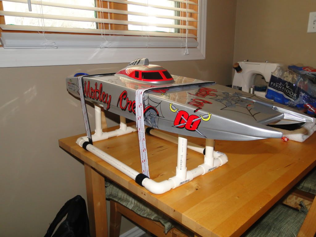

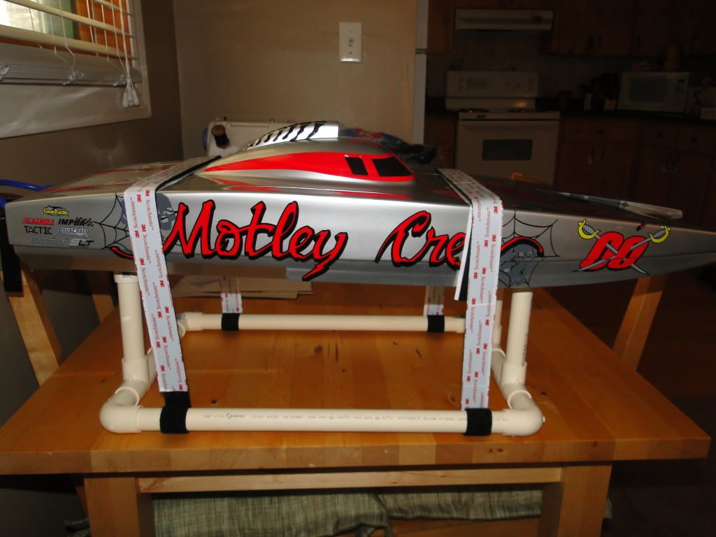

                Here are a few pics of my boat stand. I know most of you have boat stands like this but I've never build one before. $20 and about 30 minutes and its done. I have velcro straps on it so when I transport the boat its held down to the stand...
