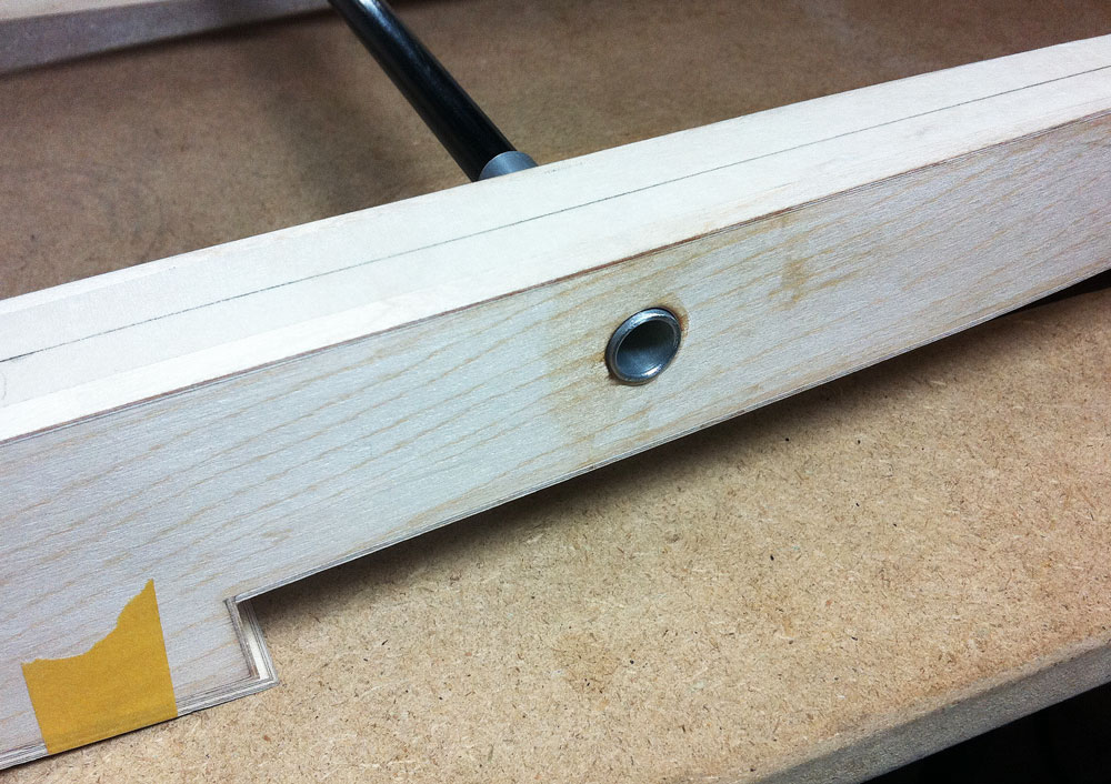

        So are those edges on the sponsons only on the front 1/2 ahead of the step ??
          They are on the rear on both and on the rear of the transom of the hull also.
          Peek at these pics:
          The bottom of the sponson is longer has a 1-2mm lip, it's not an error in design or cut. It's the ride pad(s) of the rigger.

            b4 I screw up again check this out and tell me if it looks right, BTW had to use 1/8 lite ply
              If you are just adding this to the bottom, I don't know how it will run as the AOA is not the same as designed. You can try, I hope it's ok, not seen anyone built it this way before. If you wish to just add to the sponson, the rear is good. Front is not flat but I guess you will just fill it in like you did on the hull too, so yes that is better than before. I hope she runs well for you.

                Aoa?? tell me what I need to make it right, I don't quite get ya, is the 1/8 ply to thick? what I have pictured is just a mock up to see if its right, will then fill in the empty spots, is that all?

                  There is no need to overlap the sides like that, you have the right idea with the overlaps on the bottom, although the front sheet could come back a couple of mm to fully overlap the bevel on the rear sheet. AoA is angle of attack, running a 1/8" ride plate will lift the front up but not the back resulting in a higher angle of attack on both the sponsons and the ski, it will tend to make it faster on flat water but more squirrely to drive and not handle rough water as well. thinner ride pads would be better, 1/32 ply, glass, carbon, ABS, etc, also liteply is pretty soft for sponson bottoms and will get dinged easily, if it is really all you have then glue them together over the sponsons without gluing them to the sponsons, and epoxy coat them separately, then try running the boat with and without them to see what works best for you.

                        ok heres what Im understanding>>>>>>>>> find some thinner material and attach as shown in the pic below using a 2mm over hang on the front edges of the sponson, and fair in the front part
                        think I found a perfect solution and found some 1/16 FG that will be just right...........about 2 mm over hang on the sides from the step to the front,check out the pic
                          That looks perfect! Sand and paint.
