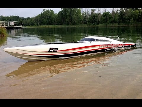

                You're not running counter rotating? Spin the props outwards and make wide turns. Spinning them in will give you more life and straight line speed, but turning will be sketchy with a step hull. My 59'' Outerlimits had similar issues. Never could make sharp turns.
                Edit: I see in your first post, they are counter rotating. Still, try running again with them spinning out.
                1:53 to see it run from the dock.
