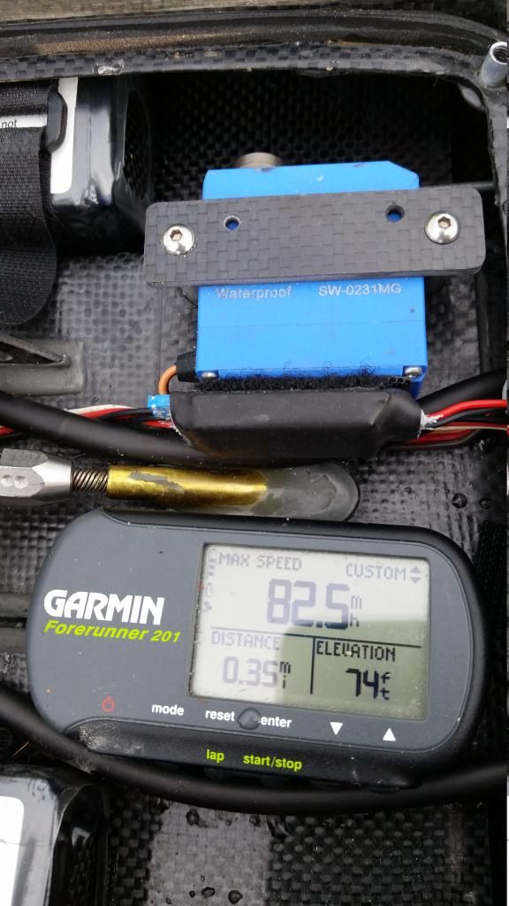

Well. I just can't get it any faster. I tried a 1816 abc (I admit I think I messed it up) and a X646 that was the best casting I've seen so far. Sharp. Thin. And after I worked it, it looked really good. I'll post some pics of the props. Meanwhile I better hang that m645 on the wall! Lol. I did get a touch higher speed. 82.5mph whoohoo! .2 of a mph lol. At least the thing is consistent! Prop pics and a video later. Stay tuned

Looks good brother, he is just being a kid. Your Fantasm will be faster and there is nothing wrong with 82.5mph with this hull, it is above the goal you first set on it....DJTunnels-PS295. Cats-H&M M1 Supercat Daytona rivercat. Monos-DF Cyberstorm HiTech 29. Hydros- Ms K Vac-U-Pickle Custom built 37" shovel 10th scale converted to FE Shadow. Rigger-H&M Evo II. AQ Harbortug recovery boat. Build in progress 37" cf DragboatComment
Thanks. I know, it fast no doubt but I'm having no blow over so I'm figuring I have more speed available in this hull. I have another motor to try, a different esc and I'm playing with props.32" carbon rivercat single 4s 102mph, 27” mini Rivercat 92mph, kbb34 91mph, jessej micro cat(too fast) wasComment

It was at 11.25 last time I did 82.3 and I moved it to 15 degrees ant it went 82.5 but the motor seems to run hotter. Esc.....Lmao. it doesn't even get warm. I'd say the motor was 120-125 degrees. I didn't bring my temp gun yesterday. I'm gonna try to make some more passes today after cutting the X646 prop. I have an x648 I'm going to cut the same if what I'm doing picks up speed. I'll post pics later.32" carbon rivercat single 4s 102mph, 27” mini Rivercat 92mph, kbb34 91mph, jessej micro cat(too fast) wasComment
