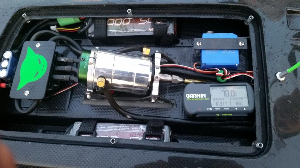

    First time out with the 1518, x642 prop 6s (all runs are 6s) t180 esc

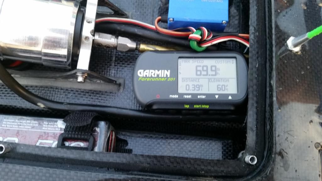

    Lowered strut to 1/8" below sponsons (no other changes)
    Swapped to a m445 prop I prepared (I do all my own props)
    Today: I did a m545 prop but first I made a backup run of yesterday with fresh batteries

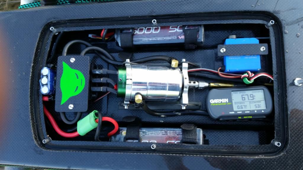

    M445 prop again (fresh batts)
      Now I have set a goal for myself. I want 80 out of it. I know, I know...10 more mph might be hard, but I can try.
      Here's the m545...batts were pulled down some from previous runs...need to try fresh ones next time.
      I'm ordering a couple more props. My temps are low. I forgot my temp gun but the esc is barely warm and motor is maybe 105-110 if I had to guess. It's got more in it....

        When you say the 1500kv "wasn't tuned in" what do you actually mean? Did you ever get a GPS reading with the 1500kv and with what prop?

            I didn't have the strut adjust correctly. Plus it kept moving and that wasn't noticed till I go rid of the motor. I might should have kept it but I'd I find myself needing to go down in kv, I'll try a tp power motor. I just got a pair of them the other day and they are nice motors.

                      you might want to try putting a little positive angle in the strut. get that nose up a little. did that with my daytona 37 single 4082. saw daylight under hull. you are running stuck to the water. after angling my strut, the hull would bounce at lower speeds, then stop at full speed. you arent going to get max speed out of any boat until you fly off the water, then trim it to stay on .

                        I got mine up to 89 mph (through timing traps, not GPS) with a Castle 1515/1Y and a Prather 235 on 6S1P. I then ran out of motor (saturated the windings), so loading it more just added heat, no rpm. The boat was stable and could easily have gone faster, but I moved on to other boats. A small boat like this needs pretty smooth water to go fast, as light ripple will slow it down several mph. And yes, until you start blowing it off you are not loose enough! A strong build is important (motor mount, packs, etc.).
                          I like it not blowing off the water lol. I think with the upcoming prop changes its going to have a little more lift anyway. I built her strong Jay.....epoxy in tips and tunnel. The sponsons have been leveled on the inside with epoxy. Jb weld on the motor mount. The transom has carbon plate and 1/4 thick epoxy built up. Whole front is filled with kintec two part foam. Carbon fiber down the sides and inlay. She kinda heavy but strong. I made efforts to keep extra weight low in the hull as possible. I have 6 sealed ball bearings in the strut. Balanced collet. I have not shortened the rudder yet tho....
