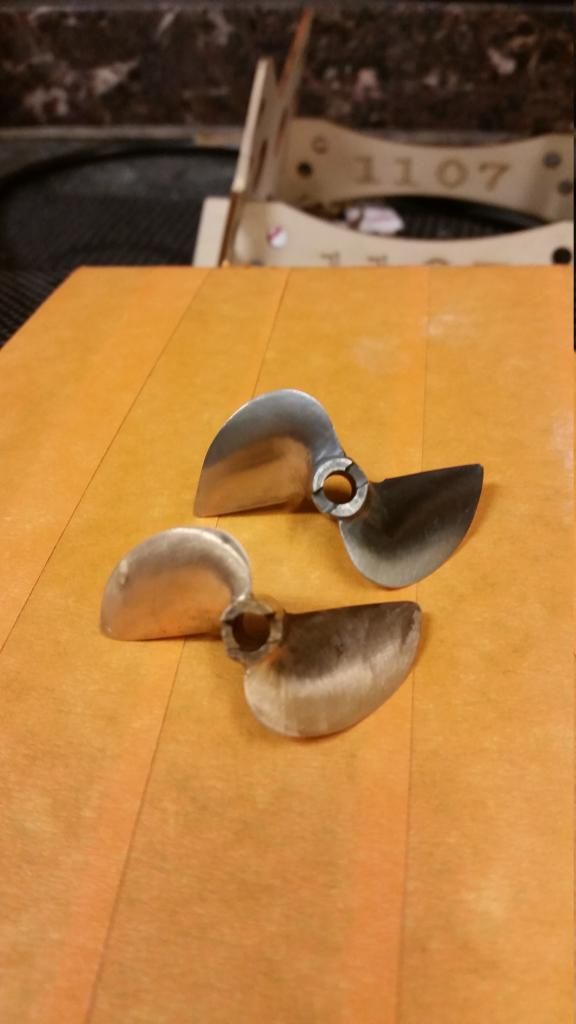

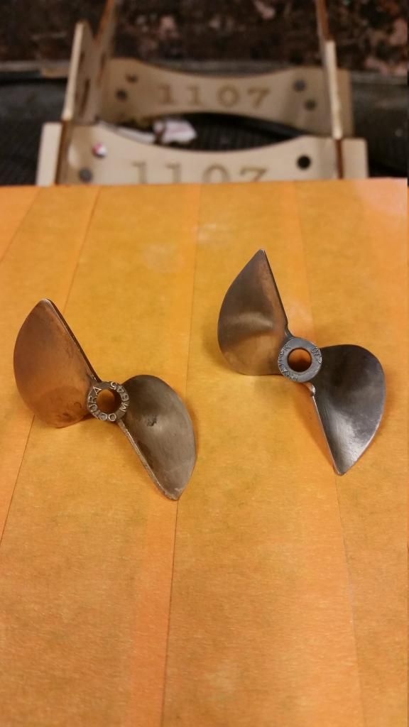

                  Thanks. I'm pretty stoked but I know she's got more in her. I'm really wanting to try a neu 1521 tho. I think it'll be a little fast on 6s. Here some pics of the two props. You can clearly tell the m645 is thicker too....
                    #54
                    Last one...

                            Originally posted by kfxguy
                            Last one...
                            That little bit of back cut should help a little too, you might want to put a little more in it. I'm trying to remember what style of back cut they call that...
