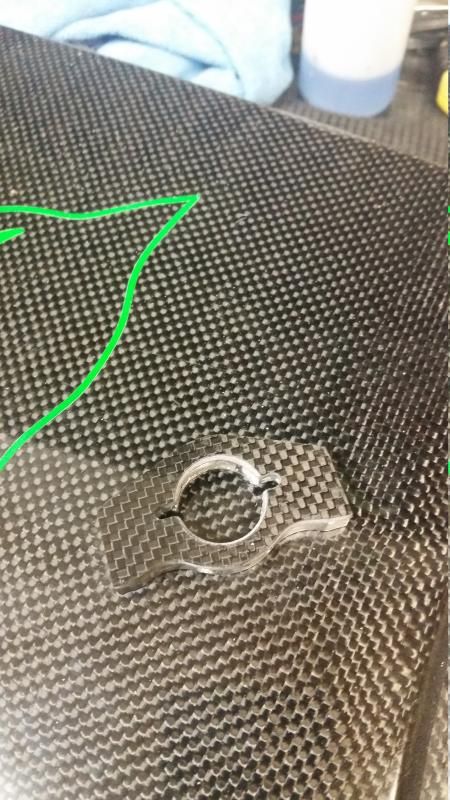

            I put an mbp collet...hopefully will hold better than the Octura I had. I had to modify a motor mount a bit. The collet is longer so I had to make a spacer on the motor mount and slide the motor forward a bit (to the front of the boat). I used some thick carbon fiber I had and cut to shape and then epoxy it to it. I also had to mill the slots, on the mount because the screw holes are a little wider on the neu motor (I guess?). Then I had to drill the hole a little deeper in the collet. The shaft is pretty long on the neu and it doesn't need to be...but to keep the resale value of it, I chose to modify the collet instead of cutting the shaft on an expensive motor.
            Mount.
            And I had to bore the hole bigger for the collet to sit close to the motor. I like the collet closer anyway because the further away, more chance of rotor shaft flexing.

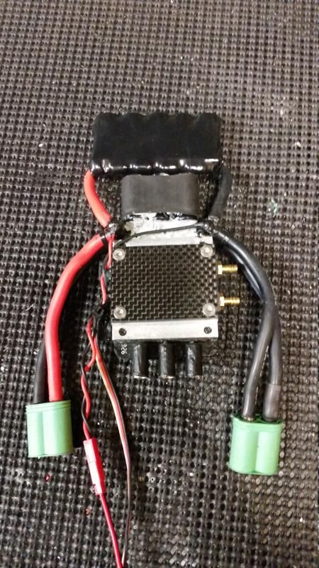

                          I can't find ceramic bearings for the motor. They are flanged so they are harder to find. All other bearing I either have or they are on the way. My stainless tubing for the water lines came in. I made a cap bank and replaced the caps on the esc with 50v versions. Also cleaned up the wiring. Here's the esc. ...

                            It looks ready to do battle

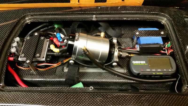

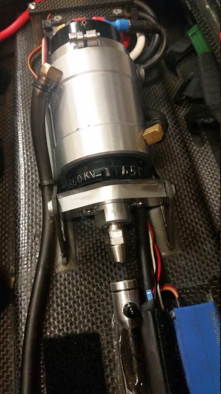

                              I had a little time to fool with it last night. Started putting it back together and Cleaned up the wiring and cooling lines. Much better I think. It's not quite done but here's a peek at it...
                              Before
                              After.....

                                OK, enough with the beauty contest Trav, lets get it back in the water
