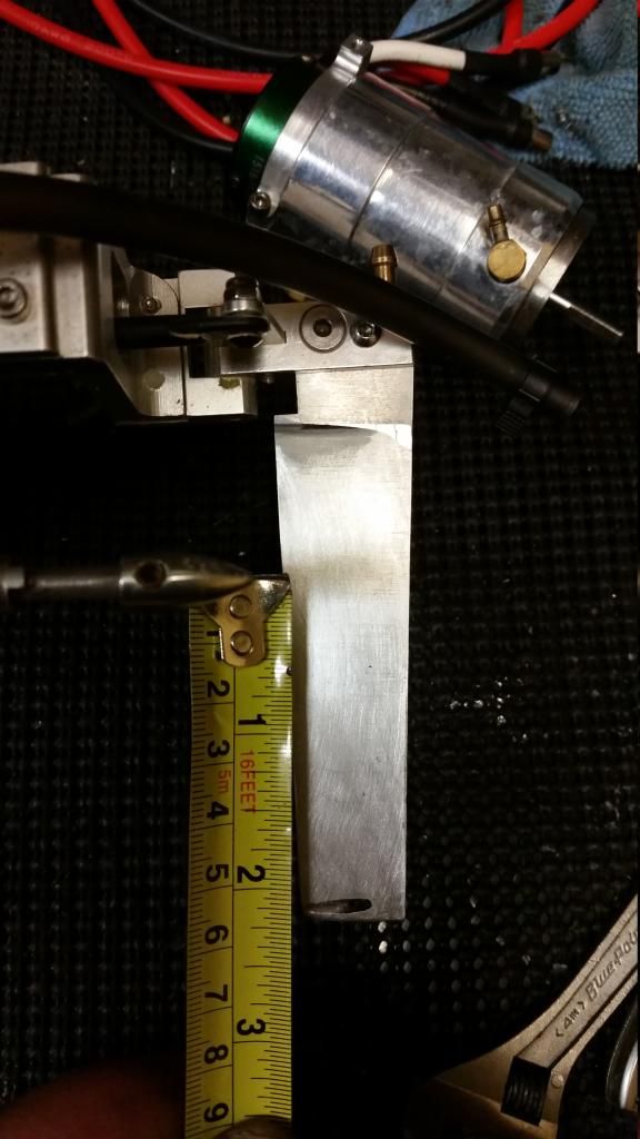

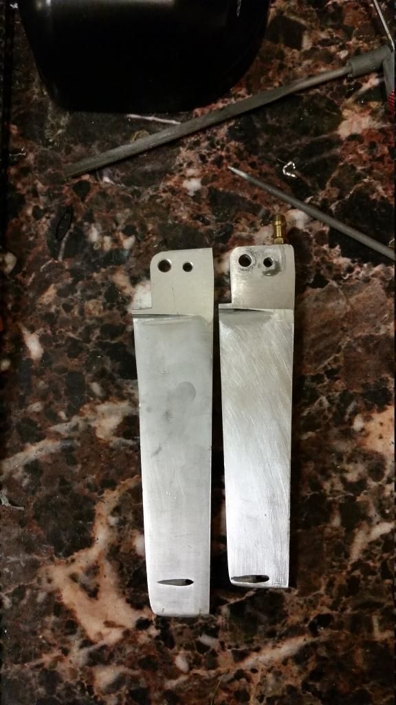

                                I found a rudder I had laying around. The thing was so buggered up I'm Suprisingly it turned out this decent. I shortened it. Shaped it like a triangle (stretched of course lol), made it sharp as I could and fixed the inlet holes as good as I could (they were messed up pretty bad). I also pushed our the little plastic plug at the bottom and threaded the hole a little and loctite a small set screw (some rudders come like this and I didn't trust the plastic plug). The one on the left picked up 1mph over a stock rudder that was slightly sharpened. Back to back with no changes other than that. So im hopi g this shorter rudder helps a tad more altho those big honking pickup holes will prolly kill whatever gain I might have had hahaha! If you have a spare rudder like these and can part with it, let me know. I'd rather start with a good rudder.
                                Next I wanted to show how far the rudder hangs below the prop centerline.....this is the short rudder....im thinking it's still a tad too long....thoughts?
