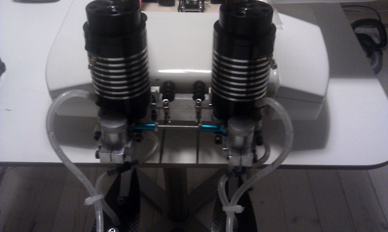

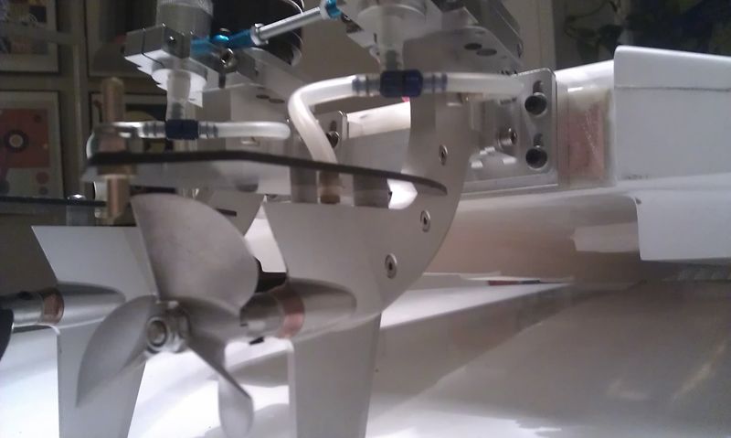

                            #28
                            I use the HOR outboards. Two of them!
                            The flexshaft is 3/16" with squares at both ends, and the propshaft is 3/16 with 4 mm thread.
                            If you wanna run bigger props you just raise the cavitation plate with washers.
                            Just be really picky about lubeing the shafts after every session! You can see my oil can-mod in the pictures above
                            25" Arrowana with Etti 2970 3300kV. RCMK Flying Cat with twin HOR Outboards. 2 x SSS 4092 2140kV. Faluga 45" with Leo 56110 620 kv on 12s.

                              #29
                              That thing is SICK!!! Dang I think its giving me wood.

                                #30
                                Hi.
                                Could you please show us more of the boat and setup,
                                Also do you have any video's of it running.
                                Thanks for any input.
