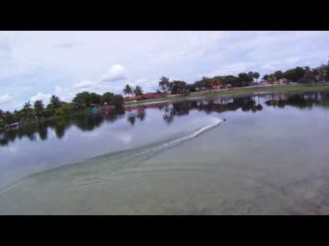

                                Here's the very first video I took today in raw form.....Lenny I'm sure will greatly appreciate it based on his warnings issued to me.....
                                I'm not sure why the sound is so low...I had the setting to the max on my video camera but the mic might be messed up. The camera is a Drift HD and I have a head strap on.
