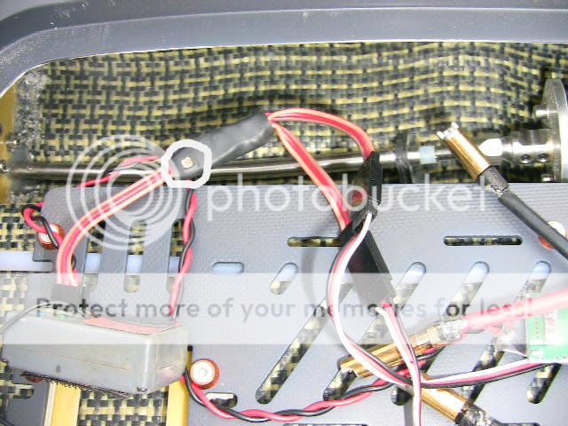

              Go to your hobby shop and ask for a adjustable Y-plug. This way you can adjust your esc's to get the motors timed together. http://forums.offshoreelectrics.com/...9&d=1344397795

                Never heard of it and it somewhat worries me but, if they said it works.....

                    charcoal gray. I plan on using it as a primer. As for the y cable it is used buy the airplane guys so it must work. This is my first duel motor so I will let you know how it works.
