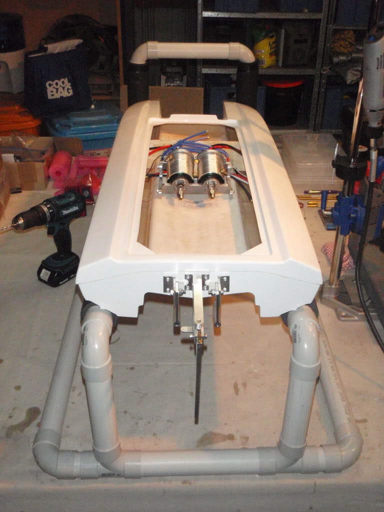

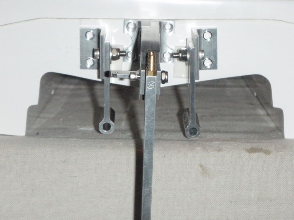

              I have finally got around to making a start on this build. After about 3 hours on the dremel, I have the stringers out and cleaned up the mess left behind. I would like any advise possible with this build being that it's my first twin. I've been toying around and have come up with a mock set up that I'm guessing might work, please take a look at the pic's below and tell me your thoughts. I'm thinking that if I have the struts the same distance as the motor couplers, it'll have less bends in the stuffing tube. To do this I think I will leave the inside strut mounting bracket off and make a reverse 90degree bracket out of 50x50x3mm angle aluminium that'll act as a backing plate and bolt on using the same bolts as the original outside mounting bracket. I'll have to buy some longer struts as these ones are too short and will leave the props far too high, if I mount them lower, it'll make my life hell trying to put the nut on inside the hull. Where should I look for a couple of 3/16 struts that have approx. 90-100mm height, or will I have to modify a 1/4 100mm strut and if so, what about the skeg struts??

                the rear shot of the boat:
                if it is sitting flat on the table top and the struts are resting ON the table top, YOU ARE SET TO GO!!!!!
                also, a nice gentle S bend is a good thing to have.

                    #39
                    Gday Danny.
                    The motors look nice !
                    And look @ COG... allow 32-35% variation.
                    CF over the tunnel ... support those 2 motors ..... stops droning and Fg movement.. roll CF 20mm over into spons .. strength in curves ..
                    CFx2 at transom or those 2 struts will tear you a new hole !
                    The sponsons are strong as is in my limited experience .
                    Fluid ( Jay ) has an abundance of cat knowledge .. rattle his cage .. !
