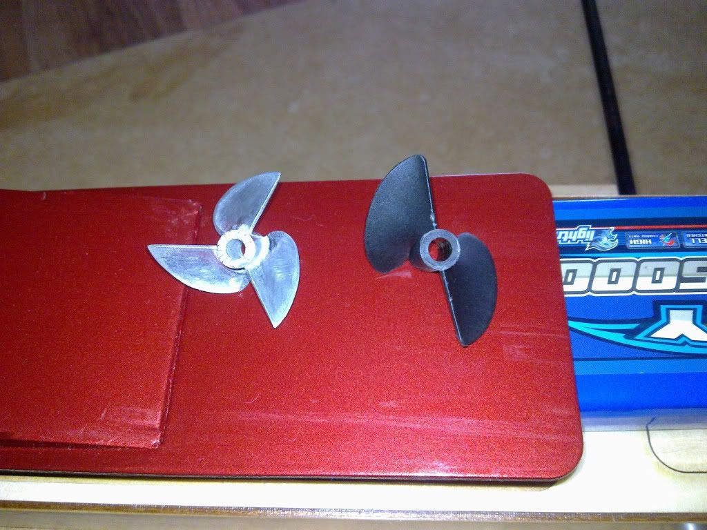

        the plastic prop on the right is what is supplied with the boat with a crap 5mm shaft hole, the prop on the left 35mm is the one i will be putting in the boat on the next run and i also have a 1732 octura prop i would like to try out but i think it may be a tad small
