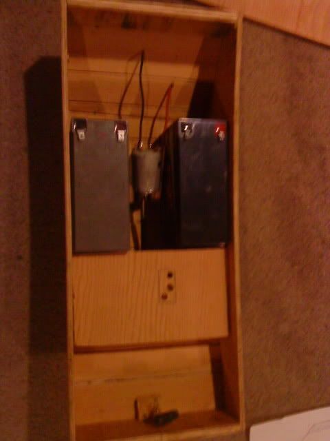

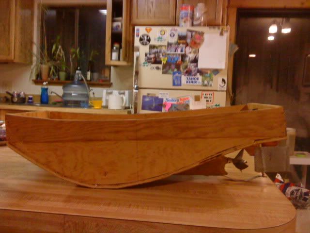

        Here's the start of my Springer tug. 18" by 10"
        She will be powered by 2 12V batteries and a 550 direct drive brushed inrunner.
        Just waiting on some parts before I can finish.
        Not to mention some warm weather so I can do the glassing....

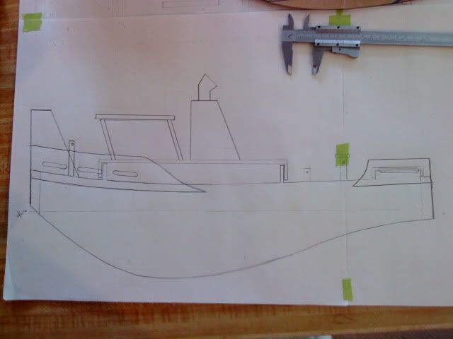

                  I'm going off a drawing but you can buy a kit or a fiberglass hull.
                  I just blew up the drawing to scale on my PC and traced right off the screen. The top deck is my own design. Loosely based off an Atlantic tug. I'm currently building a recovery crane for the rear deck.
                  Go to RC groups Dock talk, It's the first post on the page. It's a LONG thread...
                  EDIT-It is a GREAT EASY build. It's designed to be built with spare parts. even the rudder is just hammered sheet metal over brass tubing. One guy even made a sheet metal prop.

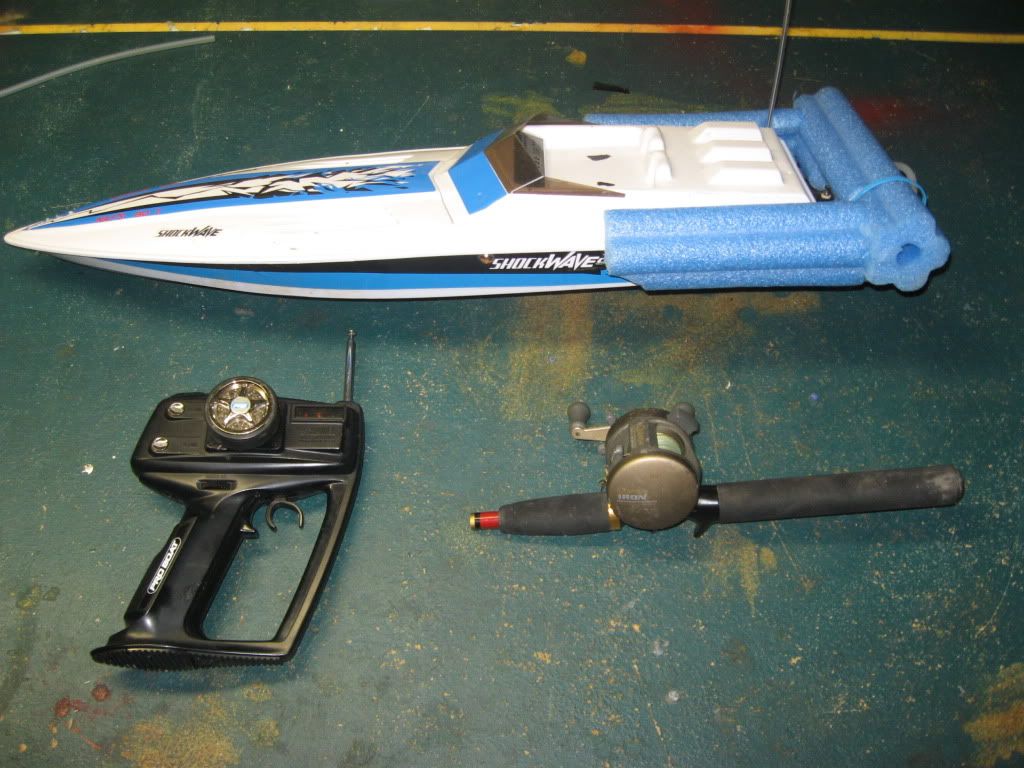

                      This is my Proboat Shockwave. It works great. I just clip the line to the Shockwave drive out and cricle around the dead boat and reel them back in. I have several hundred yards of 50lb Spyder Wire on the reel.

                        ok but why the pool noodle on the shockwave?
                        • monojeff
                          Moderator
                          • Nov 2010
                          • 2562
                          #72
                          So when the back of the boat hits the rescued rig is has some padding I am going to assume?? Also helps it from swamping...
