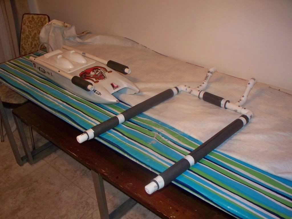

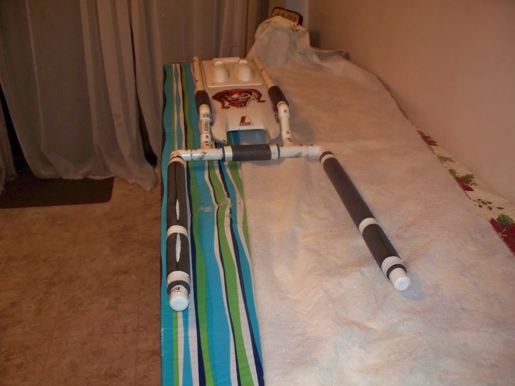

                          Here is my Apache rescue rig. It fits perfectly across the back seat on my 98 Civic 4 door. As you can see I notched the pvc fittings to fit the hull seams then I CA glued everything. Works like a charm and I would never run my boats without it! It's powered by a Mamba Max ESC in a balloon and the motor out of my Miss Geico. When at the lake, I plug in the ESC battery and tape the lid. It's stays on all day and only the radio gets turned on and off as needed. The boat and radio sit by the shore so anyone can use it when they need it. It puts in major work and doesn't break a sweat!
