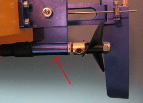

      I can do that this evening when I get home. I did work on this problem last night. I did two things:
      1. Slid some shrink wrap around the shaft and put that over the strut to seal the connection between the shaft and the strut.
      2. I "corrected" the issue of leaving a gap between the drive dog and the strut. Now the teflon washer will work as it was designed to and there will br zero gap when the prop pushes against the strut.
      Hopefully, this will fix the issue, just too rainy here right now to test. I will let you know.
      Either way, I will get some pics out tonight if someone else does not beat me to it.

        This picture is with the prop pushed in tight.
        This picture is with the prop pulled out.
        I also put on heat shrink and filled the void space the red arrow is pointing to with cotton soaked in oil. I light packed it so not to cause fiction.
        never got to try it out as it the esc went up in smoke.
        Also the esc was mounted with the cooling tubes and motor wires pointed forward.

            Having the prop dog/spacer snug against the strut helps eliminate internal stuffing tube pressurization. That *should* eliminate the water in the drive cable that's pushing grease into the hull.
            If I'm reading this correctly, you can push/pull the prop/shaft in and out?
            If so, the dog should be adjusted snugly against the strut with the prop/shaft fully extended out.
            If there's a gap in the strut - prop dog space, water will enter the hard prop shaft and work it's way up the drive tube into the hull. This is when the cable's grease will end up in the hull. eeeew. Messy.

                Correct. It's so good that it pushes ALL of the greese out of the shaft so when you pull the shaft out it is completely "clean". Can't wait to drop it in the water and see if this problem is corrected. Of course it will not stop raining....

                  I discovered this with the apparition. I was using a 3/16 nylon washer and it kept cleaning the drive cable... right into the hull!
                  Changed the nylon to a 4mm bushing and voila. No more leak.
