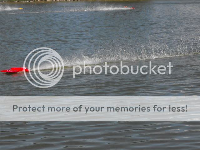

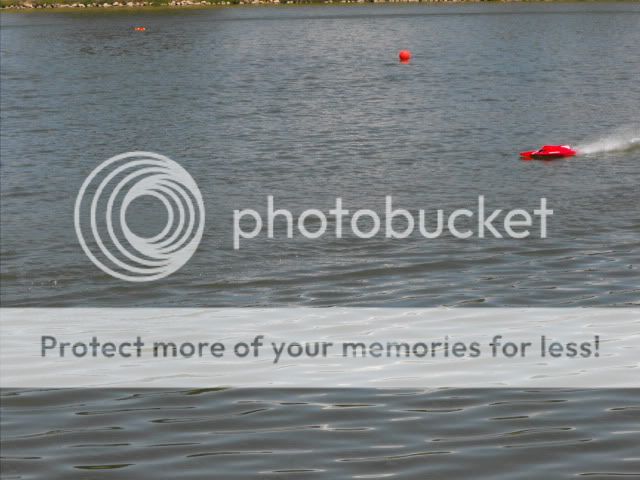

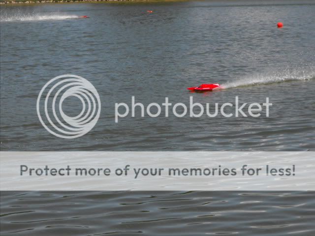

                Congrats!
                Hey that's my orange boat dead from losing radio signal. Sean you need to keep that red boat from getting in the way when people are trying to take it's picture!!
                      what can I say... I'm a camera hog
