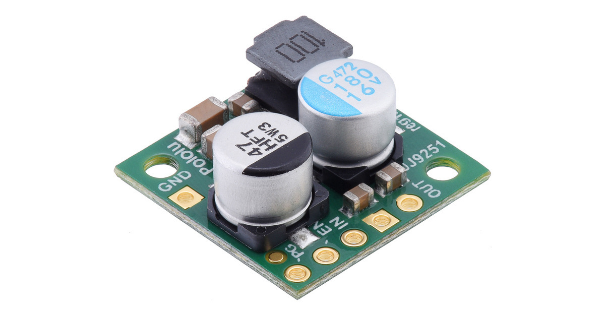

                      I got my two water pumps installed, These are flow through pumps,
                      This means that when the water flow is higher then the output of the pump, It flows with no restriction.
                      The flow on these little pumps is over 1 US Gal per minute.
                      There draw is only 0.400 A, so for the two of them is only 0.8A
                      To power these I use a
                      This will take up to a 36V input - with a 12V at 2.2A output.
                      I ran two of these pumps in my 6S twin all last year with no problems.
                      Last fall I put one of these pumps in my humidifier it has been running steady for six months now with No problems.
