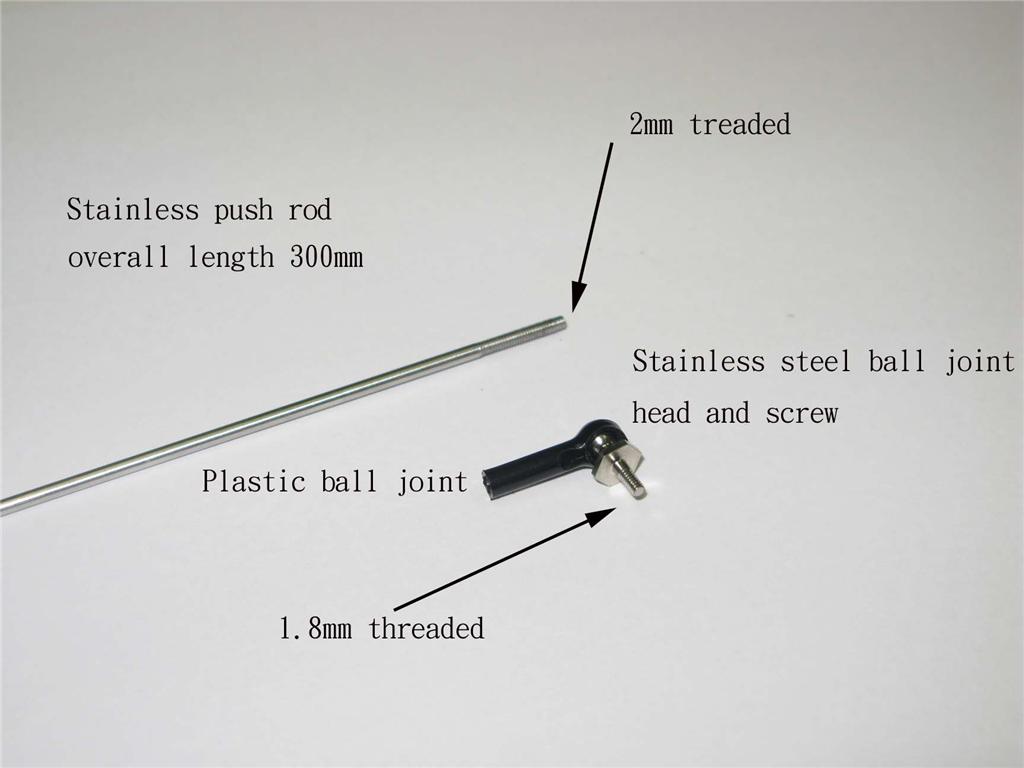

      What steering linkages you use?
      ordered this with the cat and thinking what else I need to get. (i have upright and laydown servo mounts)
      Would one be enough or maybe use 2 and make it push/pull?
      Is that hardware what I linked on post #224 threaded to fit these? -that would be too good I guess...

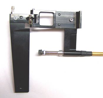

        they rudder/strut has its own steering rod holder,the rod just slides threw and gets retained with a grub screw. would be hard to do a push pull set up not enough room to stand a servo up

          Scott to the rescue again! , I watched that pic again..it does come with steering rod holder!
          So if these rods I ordered wont fit(if the threaded part is 2mm,so 2.5mm the rest of it??? ) can I use some piano wire or what do you guys use?
          -how do you attach that (what ever you use) to the servo ? -just bending it or is there some trick?

            Pate not sure what you have for a hobby shop close by but this is what I use that one of our local shops carries.
            along with a 4-40 piano wire rod that is threaded on one end for the ball link and solder the kwik link that connects to the servo to the other end of the rod.

              Thanks Ken, I emailed that pic and the links you provided to my lhs, will see what they reply.
              Maybe that 2mm rod is too thin what I ordered, but idk until I see it. If I can get that 4-40(3mm?) locally, I will get it

                              How did you guys instal that hardware on transom?
                              Did you strenghten it with anything? -gluing extra plywood inside the hull is not going to be easy, this is so low hull at the back.
                              Maybe I should just dab some c/f cloth in there?
                              Motor mounting location should be easy to choose...the motor will only fit inside the cockpit

                                I cut a piece of ply and epoxied it in the strut holder. Before it hardened too much I drilled and used blind nuts...I had to use hemostats to hold the nuts to get them started...a real pain but worked and they are not moving. Now I can remove the bolts and nuts stay there.
