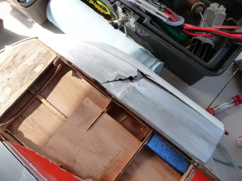

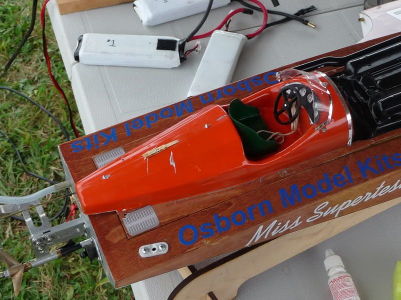

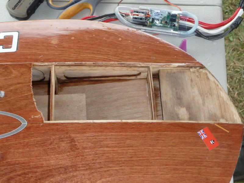

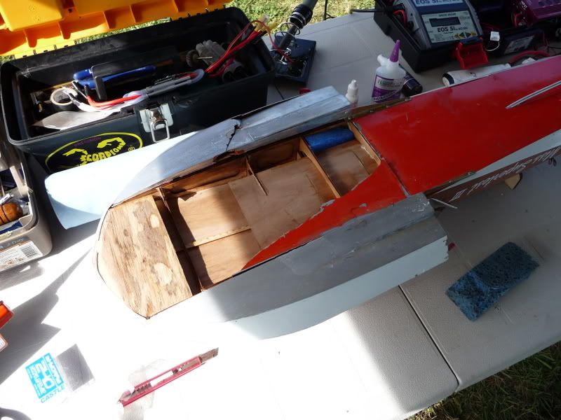

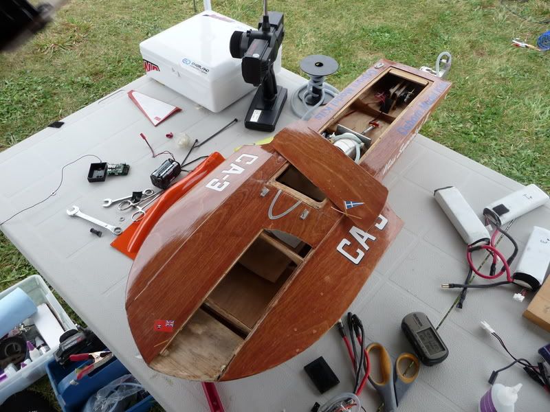

                        Sorry I missed the carnage today. I really wanted to get some good video and pics.
                        Team Liquid Dash
                        • Eyekandyboats
                          • 1921
                          Originally posted by Doby
                          Didn't run very well after you skewered that bouy though
                          in my FE1 hydro yeah... damn entrance bouy.....
                          this one i am talking about is the one larry trashed.
                          pictures at the end of the race
