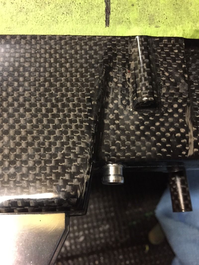

                Nothing special but a crucial part of the build. The linkage boot fitting. I always make my own for several reasons. One is because the diameter is smaller allowing the small boot I use to fit better. Then I make a smaller hole in it where the rod passes through. I find this stops a lot of bending and deflection the rod could have. This linkage is pretty much a straight shot and I want it tight as can be. I also make my own because I reinforce the transom with epoxy and chopped carbon so it has to be able to pass all the way through it of course.

                  And how it looks. It's jb welded in. Perfect spacing.
