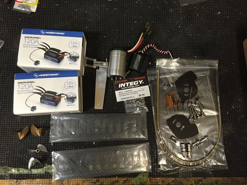

    Castle 1415 2400kv motors
    Seaking 120's with castle cap banks
    Lhs waterproof servo
    Ose .187 flexes
    Custom built ball bearing drives.
    32" carbon hull
    Octura stainless collets
    Center mount rudder
    Carbon motor mounts. These are neat because you put screws in the motor, slide in the big holes, then twist the motor a tad and tighten
    Ose cooling jackets
    Cnc 442 props to start then abc 1615-17-45 counter rotating beasts after
    3s or 4s pack per motor
    Dual cooling

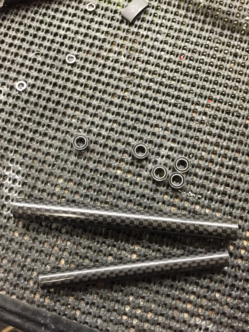

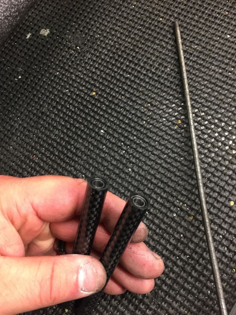

    I just got through making the drives. I'm using carbon tubes. One size the 5 ball bearings go into. Then there's a tube epoxied into the larger tube that the bearing back up to and the 1/4" brass slides in. After much research and talking to Rocstar and Keith, I've decided on fixed drives. They will be fixed level. I'll have to make any adjustments with Cg and prop choice/mods.

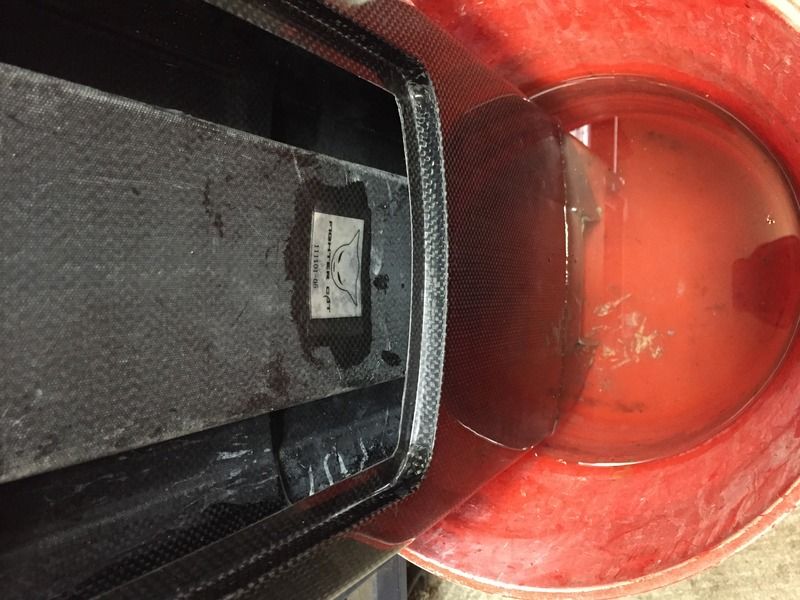

      It's sitting in a bucket of water right now. Poured 20 grams of epoxy and chopped Carbon in each tip and the tunnel. The water helps to keep the heat down in the tips while the epoxy cures

                Lol. See those two carbon tubes with the bearings? That's the drives, not much to them. They will be braced at the overhang of the transom. I may end up switching motors but these will do for now. I figure it should do 70ish on 4s per motor. Heck, my little mono is doing almost 62 on 4s with one motor so I'm sure it's doable.

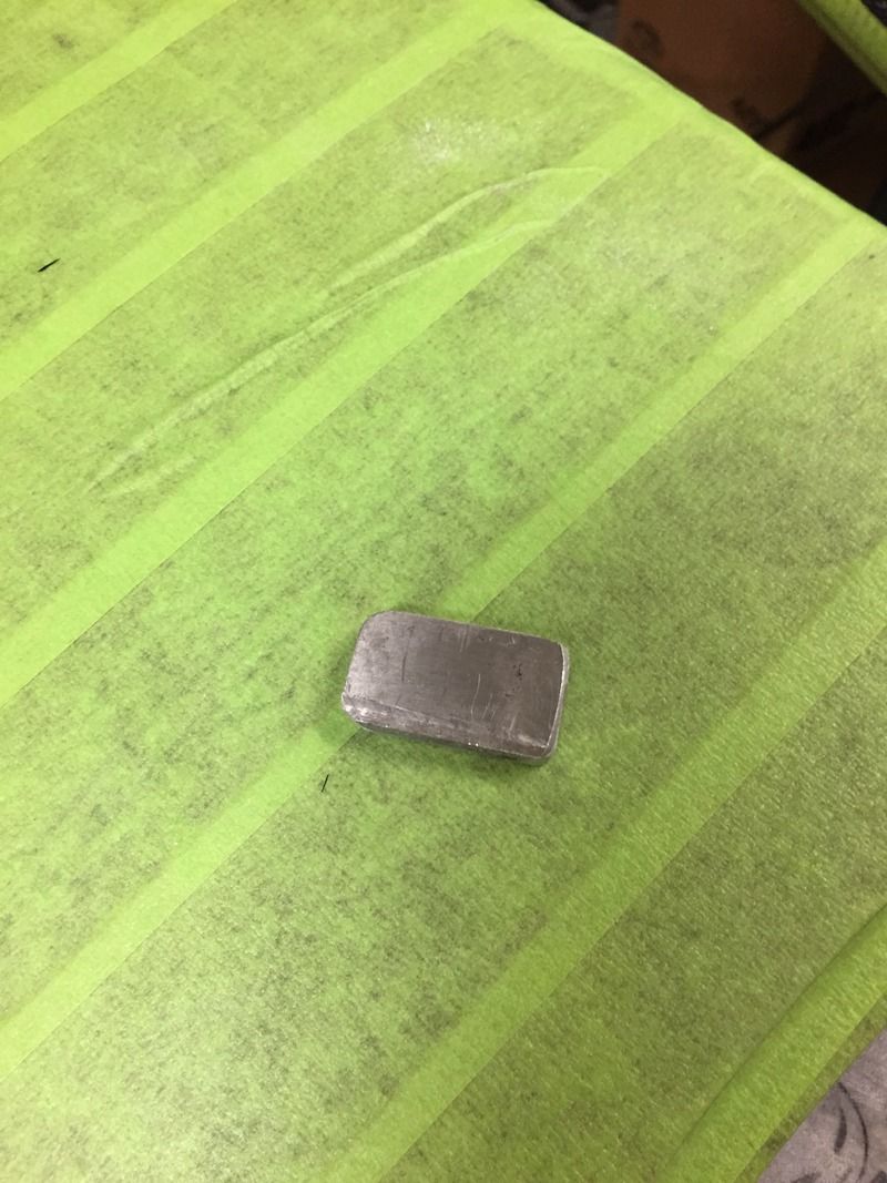

                              Got a little done tonight. Didn't get the inlay done but got the carbon cut out. Then I laid several pieces in the transom area. Hard to get in there so I had to do it in pieces. I also made a thick aluminum plate that reinforces the rudder mount area and I can drill and tap right into it. If you e ever had to get to the nuts in one of these hulls, you know why it's easier this way. I flooded the transom area with epoxy and chopped carbon fiber too. Im going to put epoxy and chopped carbon in the bottom of the sponsons where it recesses. Nothing special but the little plate I made.
