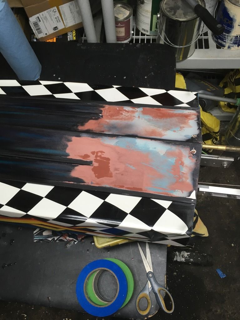

      Allright, the hook is remedied. Shot of black and good to go

        Just a suggestion, would epoxy mixed with micro balloons for sand ability be a more durable filler?
          Sent from my SM-G950U1 using Tapatalk
          That is what I use.
            If I was going for max strength I would just use epoxy but it’s a PITA to sand. The bulk of that in the pic is ‘bondo’.
            It was recommended by a friend and I must say I like it. You can get it set with hardener so you can sand in 15mins. Quick job for a larger area!

              Bondo is what i have been using for any straightening on my DV-60 as well.... easy to work with and easy to sand... and weatherproof (gotta love automotive products)
                what did you change on the bottom? I can get one of these but it's far away...
                  Hey Ray, how have you been. Been awhile. It had a good concave hook in the bottom (also water intakes but I left them). They are pretty old hulls so depending on how they are stored they can distort. Does the one you can snag have the hatch too? It took me some time to find that.
