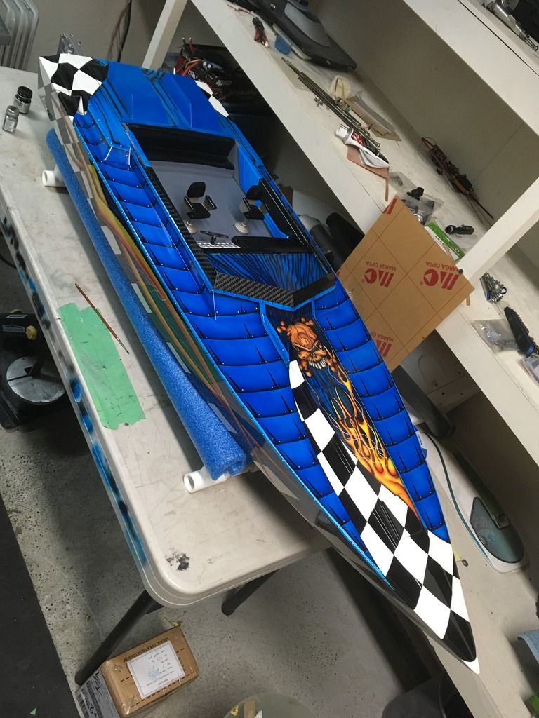

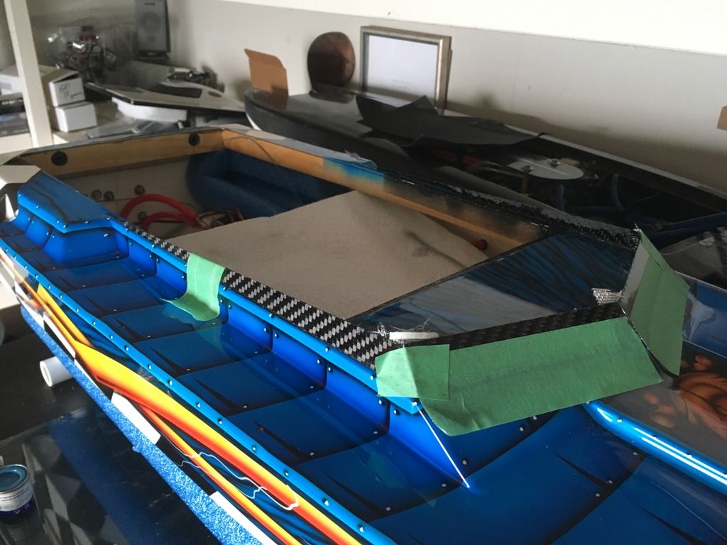

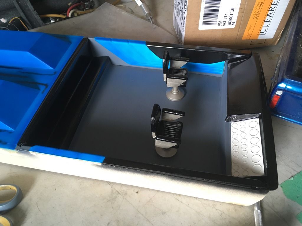

        Well let’s see how this turns out. A much slimmer windshield than it came with.
        And the cockpit area is coming along (seats just placed ATM)

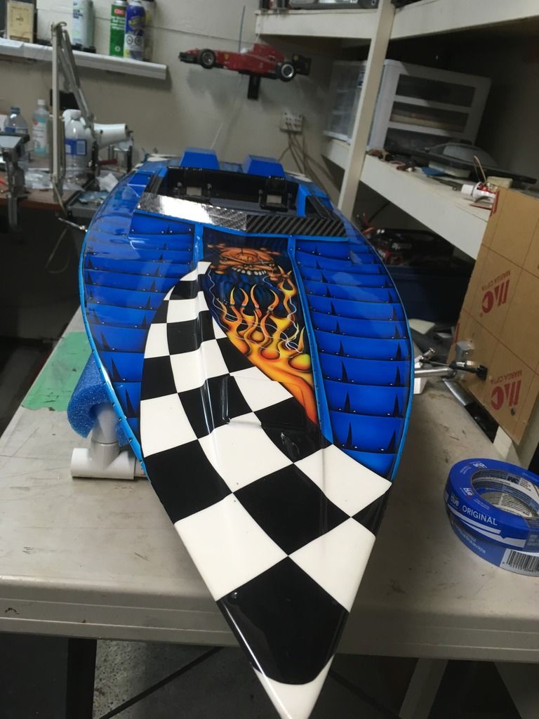

                And at long last, just a flex to cut to length, install a prop and hit the water...
                My U-pol Clear worked well!

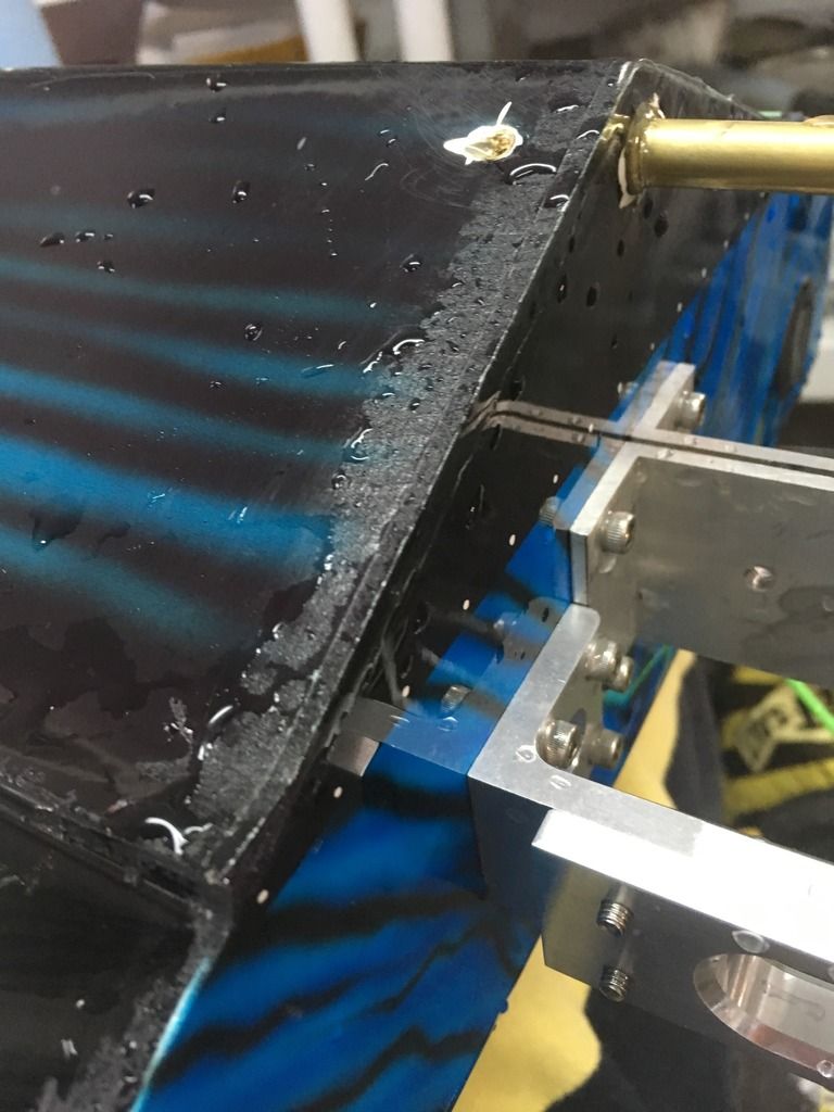

                      So it got in the water today
                      Well mechanically speaking it went well. No water in hull, everything cool, was capable of great speed, BUT.....
                      As soon as good speed hit it was hoping all over.
                      Then I remembered that I epoxied an edge to the rear of the hull.
                        • 7673
                        #56
                        This hull trailing edge was real round and of course a sharp edge is wanted. I had left that to cure real good so I could sand it. A month should be enough. lol.
                        And upon sanding and grabbing a straight edge for it I discovered terrible concave in the bottom that made it up to 1/8” about 3” ahead of my epoxy work. SOOOO, more work to do and there goes the pretty bottom paint! Anyone say Speedcote?
