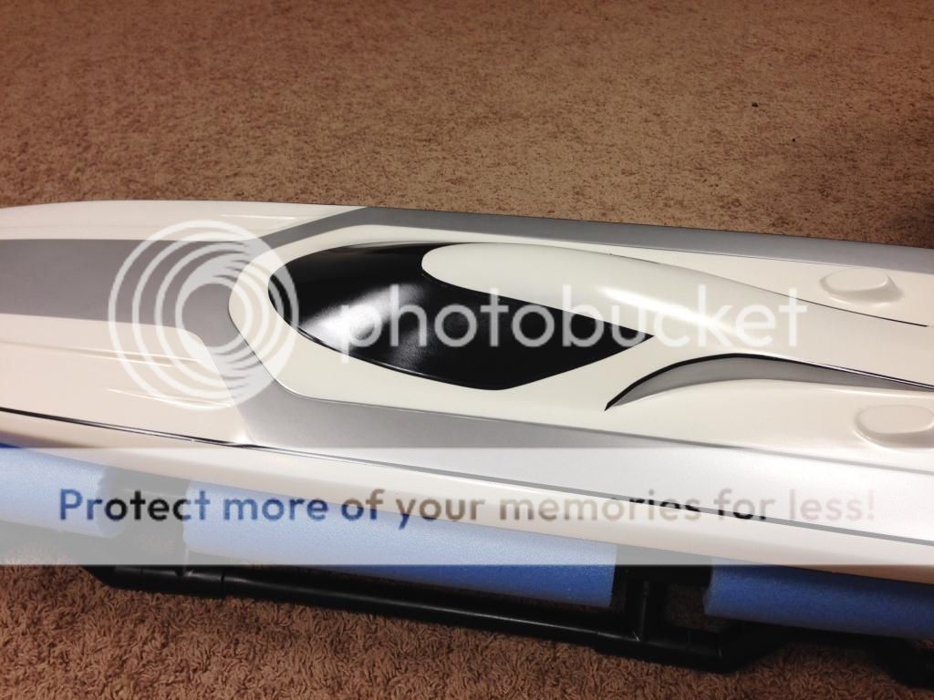

      Finally getting back to this one. Since I had to fix the chip in the nose I also filled the top of the hatch where the scoop would go (if I were using it). Quick and dirty paint job....SAW boat, so I really don't care about paint, but that recess in the hatch was bother me, so it had to go. Waiting on a few decals from Monojeff.
