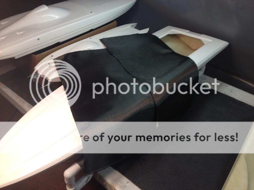

    Well, this is it! This is an idea I started working on last summer. The plan was to build it over the winter, but for some reason the hull took 19 weeks to arrive. Once again I'm in uncharted territory with this build. I will be throwing some ideas around and we'll see what happens. Starting with a DF Sniper 45'', I reinforced the seams with CF tape. under the deck I did strips of Coremat and of course two layers of carbon fiber in the hull. The hatch received the same. The strips of Coremat add a lot of strength while adding less weight then covering the entire area.

                      ON Coremat / CF layup,
                      How did you attach all that to the hull? Vacuum bag?

                          No, the reinforcement is all hand laid done wet on wet in one sitting. Took some time, a lot of resin, rollers and patience. I will also be adding additional support under the deck.
