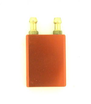

    Good Work on the water cooling plate...
    It looks like more work than it's worth, however... For those without a mill, I used one of these to convert my Mamba Max Pro ESCs to water cooling. For the price, I just couldn't justify firing up my own mill.... They are only $5.95... plus shipping, of course...

      Its still a lot nicer. Plus the satisfaction of doing it yourself. Sure beats sitting in front of the tv waiting for the mailman to come!

        I know lol. I saw those and its cheap.....but I had to order...wait and then do something with the orange color that didn't match. Plus mine has more capacity lol.
