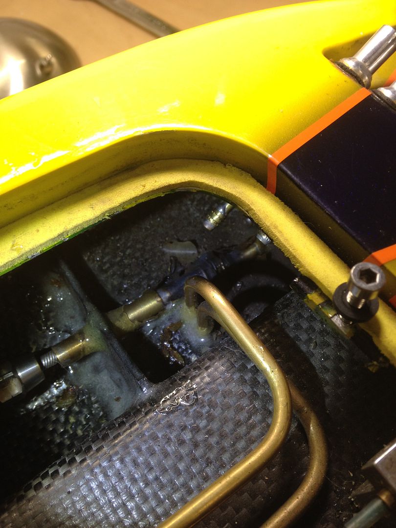

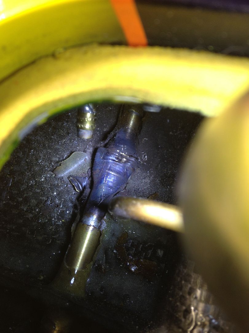

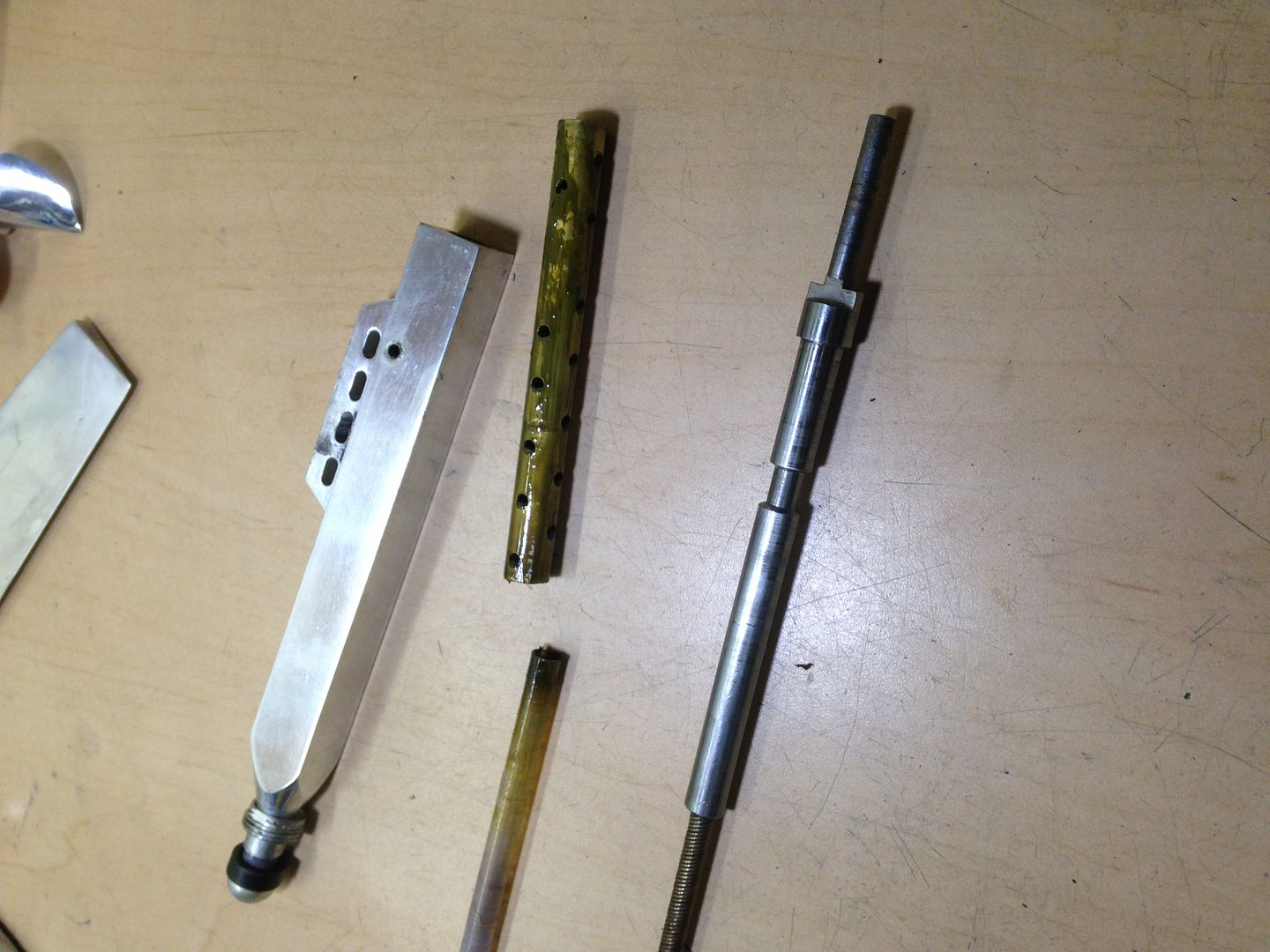

                              Well after a little time away from the water I'm finally back getting wet!!! Got the MADD Catt out and have some repairs to do on the one drive line, a little too much prop with a little too much throttle netted me a twisted flex. I made my own drive dog/shaft so I would never lose props again. Well I still have the drive line and prop but the flex let loose in the stuffing tube. It's gonna be a **** to get to but I'll fix it!!
                              The shaft and stinger,
                              And the problem area, short as possible tube and heavily reinforced, but not enough for a flex to let loose at 50k rpm!!
