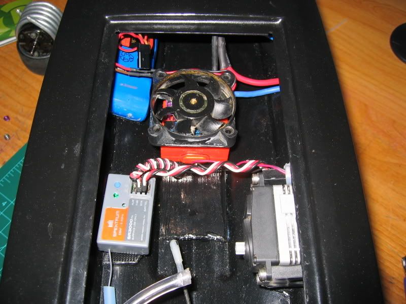

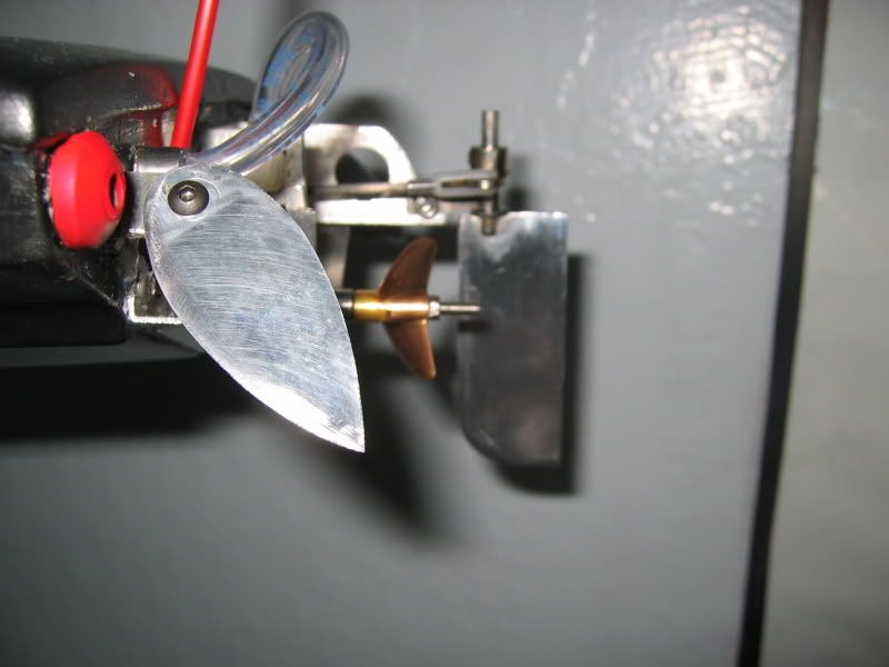

            here are some pics as promised
            rudder difference
            the rudder is dark cuz i had to un-braze it to get the mount off.
            same sized turn fin
            servo and mount
            the inside improvements

              Um, where do your batterys go?

                The flex cable will shorten at WOT. Leave a gap between the strut and drive dog to allow for shrinkage.

                  tha battery goes right behind the speed controll..

                    its not done yet. but thanks for letting me know.. how much of a gap should i leave?

                      the blue battery is for the fan and it will be on that side to help ballance the boat. all of the electronics (escept servo) are velcro'd on so everthing will adjust if i have ballancing issues..

                            hey reddy.. how big of a gap should i leave between the strut and drive dog?

                              wow.. im a little stupid.. how could i install the servo without checking if the motor fits.. to my luck it doesnt.. well no im so angr im gonna have to redo the servo again.. this time im just gonna go with the mini servo and forget about the big one.. im so STUPID..

                                I would leave 2.0 - 3.0mm gap.
