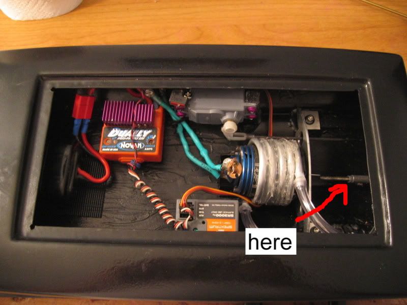

    yes i am.. im planning to do the moter conected straight to the esc with deans wet noodle wire..

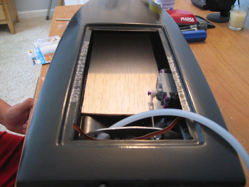

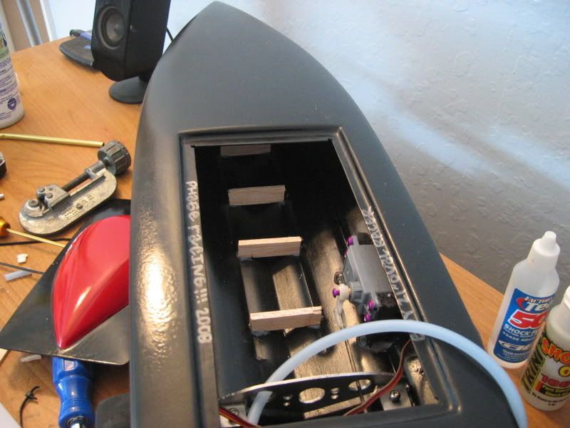

      oh yeah i forgot
      i put a piece of balsa wood in the center to keep the electronics out of the water(just incase there is a little puddle on the botom
      i sealed the wood and then painted it black

            im almost done..
            here are some pics

                    wow i just realizied i messed up real bad.. i only sealed the top of the wood.. i didnt seal the other side and i didnt seal the 4 supports..
                    i suck for that.. but what can i do. lol

                          It looks good and want to see the video. It's always nice when you can use some rc car stuff you might just have lying around to put in a boat. I want to do the same. I've done the same as far as forgetting to seal some wood like that it's all good. The one thing thats hard to see in the pictures for sure but make sure your water pickup is barely sticking below the hull or it will cause more drag than you want. Those kind of pickups work well and I see you put it towards the center of the hull so it doesn't pull to one side . Perfect. Nice job on it. Have you built any boats before? PS somtimes it's hard to get a responce on this forum but for the most part people on here help a ton.

                            thanks man.. i have the water pickup attached with 2 zip ties so its adjustable.. i have never build a boat before.. this is my first one.. thanks
