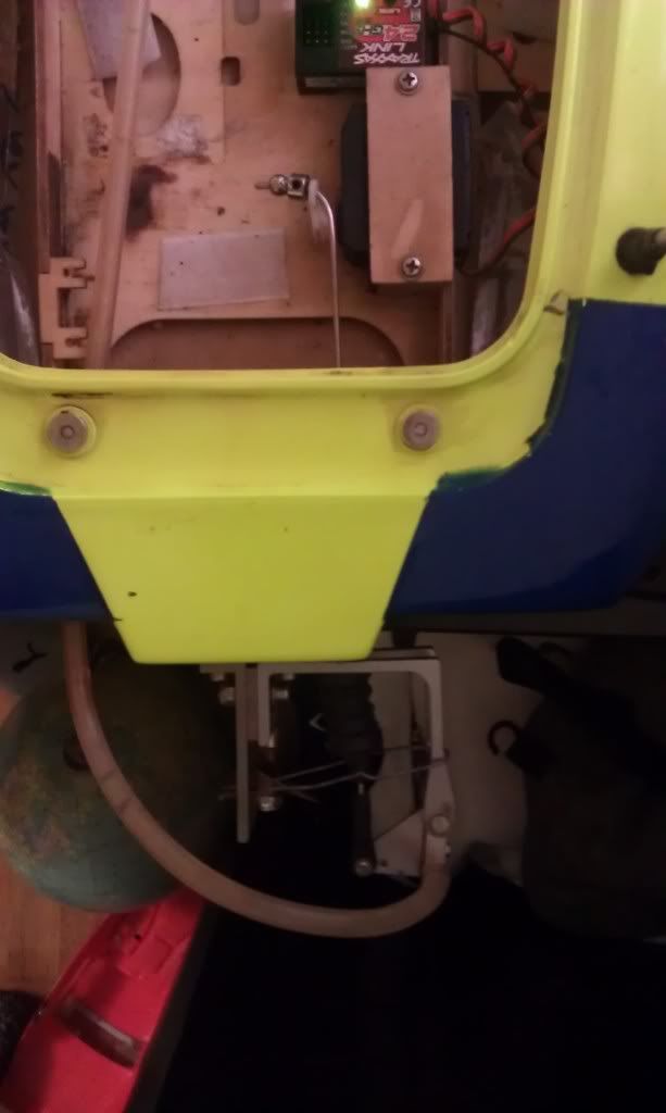

      Thanks again. Ill go home and fix that tonight.

        Hey no problem if u can't read it that good let me know I will email them to you

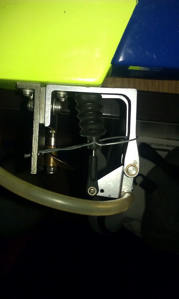

            Bent the link and reversed the steering.

              Also did the strut adjustment. It was about 1.5 cm higher than the bottom of the hull. Now its flat.

                    I think so. I also moved the rod up a tab on the horn to get more steering and i moved my epa on my transmitter down. Ill mess with that my next run. I wish the forecast was clear and sunny but.. its dark, rainy, and windy....
