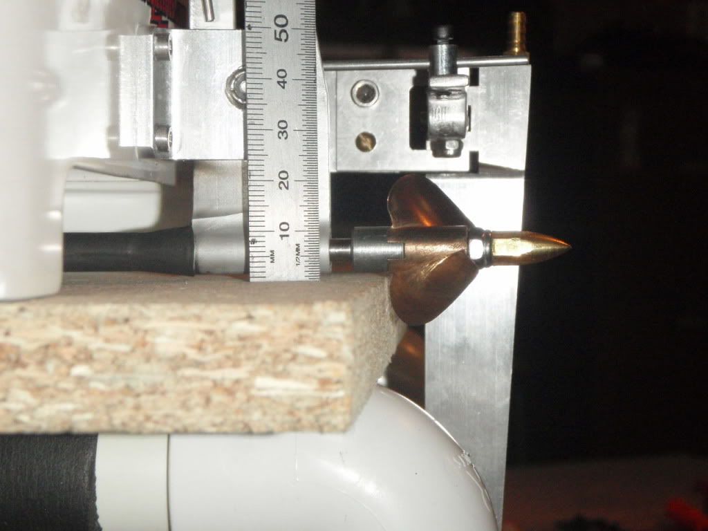

      I made a few improvements and adjustments last night. I made up and external antenna tube using a water outlet that I put into the hatch the opposite way, a length of silicon tube and a standard antenna tube, I used rubber o-rings to waterproof the water outlet onto the hatch and the silicone is very tight on the plastic tube, I had to spit into the silicone tube for lube to get the antenna tube to run through it, now it's dry and wont budge. It'll be real easy to just slide the antenna into the tube as I fit the hatch b4 a run, as long as I remember. I also re-adjusted the strut bringing it down so the center of the shaft is 5-6mm above the sponsons and made sure it's at zero angle. I had to replace the rudder as it was easier than trying to bend it back streight, it was bent and slightly twisted, wow.

        Is there a reason the prop is backwards?? did I miss something?
          Use your other eye.
          Look's correct (CCR) to me.

            ha ha, I see it now, the picture makes it look like the cup of the prop is towards the front. I had to look at this picture over and over to figure it out.
