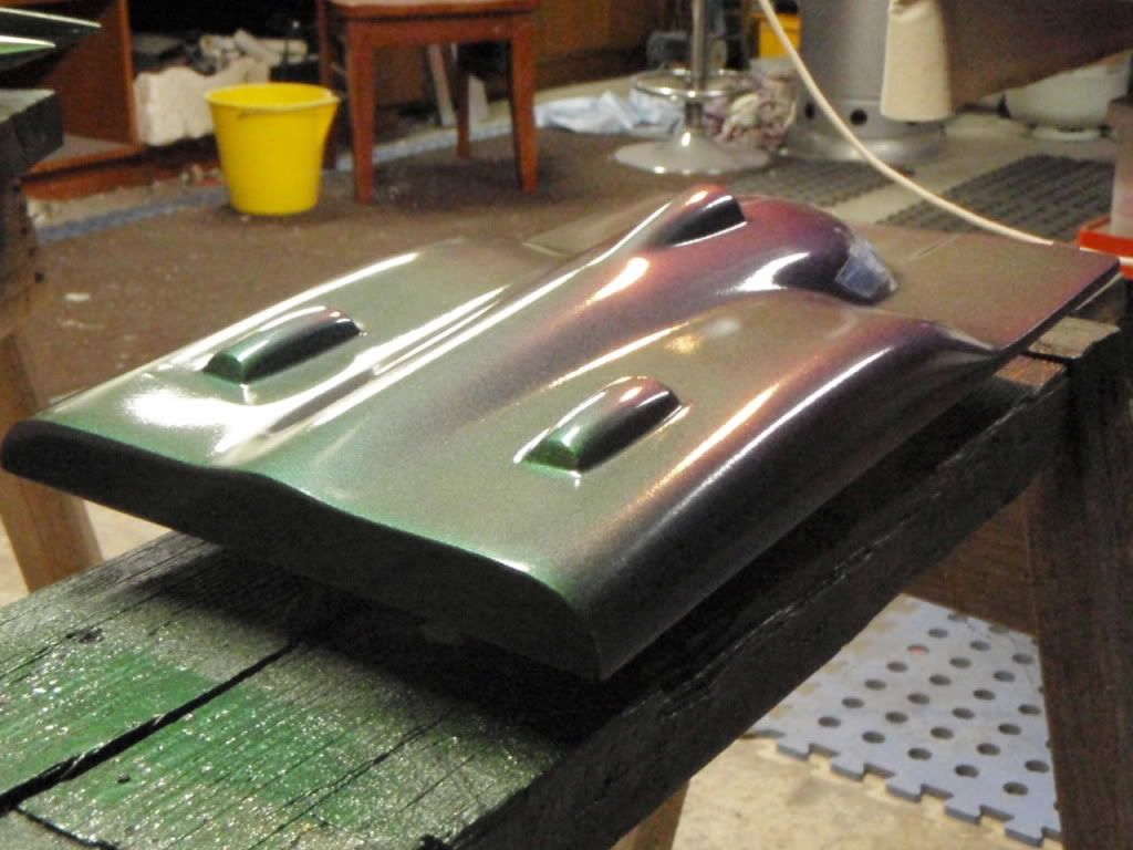

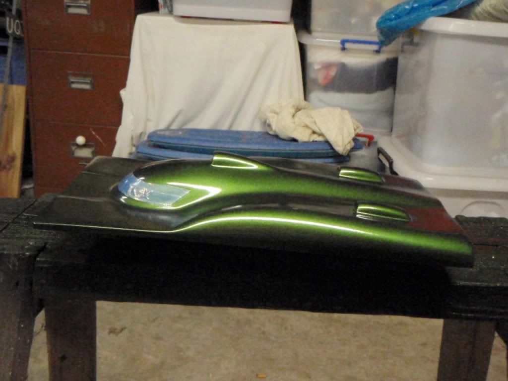

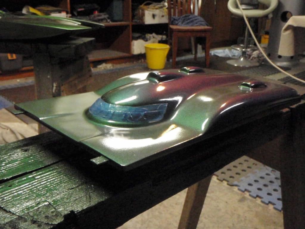

    Here's a few of the hatch, I was able to get a few shots with more color comming through. No I just have to add the stickers and clear coat, then it'll be test time.

      Looks good! It's going to be beast with the 1717 in it!

        thanks, I'm getting itchy fingers to drive it, I hope to get the clear coat done over the next day or so and then stick some batteries in it and throw it in.

          looks nice man! gotta get some still shots on the water on a nice sunny day
          • ron1950
            • 3024
            looks great....even though i know nothing about painting....if u race it remember black bottoms are hard to see if u flip it

              I don't race either but I have painted the bottom of the sponson, tunnel and transom, white. I'd read that and thought that'd be important, I can see this boat landing upside down a lot, lol

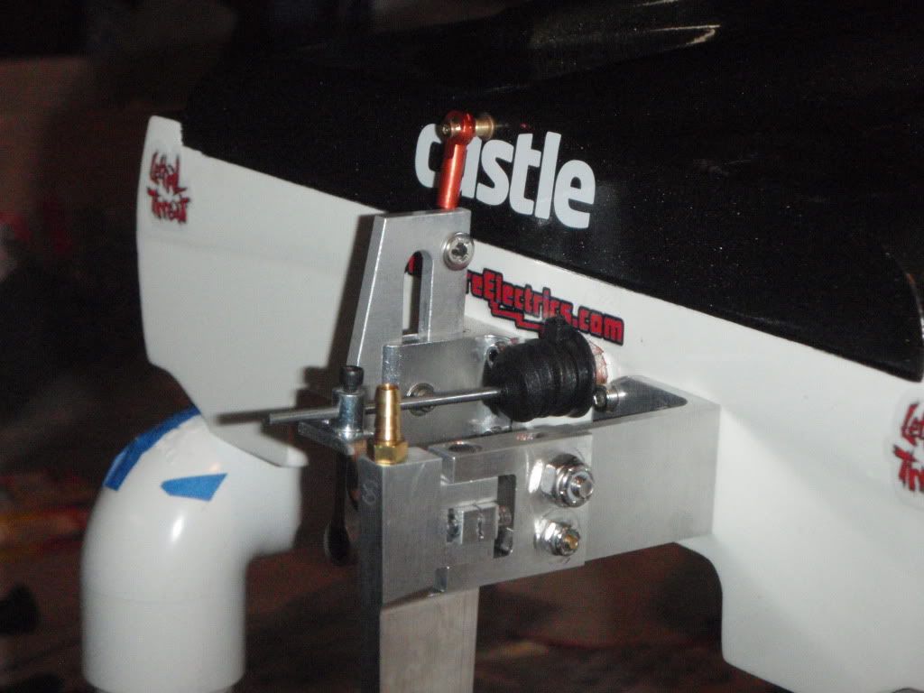

                Last night I fitted a speedmaster .21 rudder assembly, after a few mods I've managed to get it all fitted and set up. My question is, Does it really need to be this long?????

                  • 3573
                  #23
                  I cut an inch off mine. I think it doesn't need to be that long but it doesn't hurt. Either way, mine handles and turns fine with it shortened up a bit

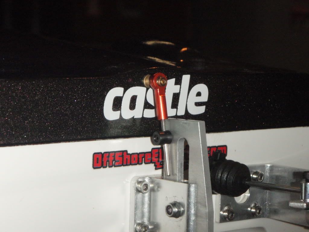

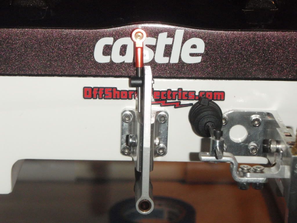

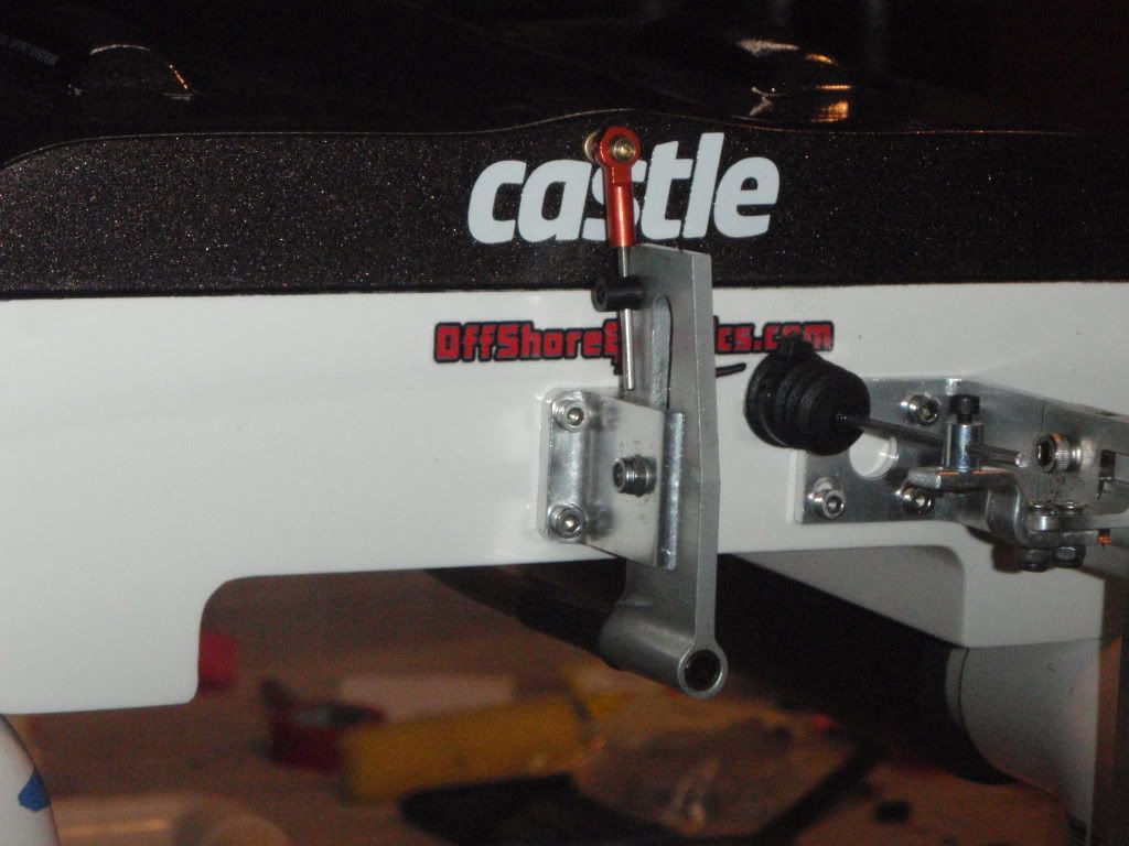

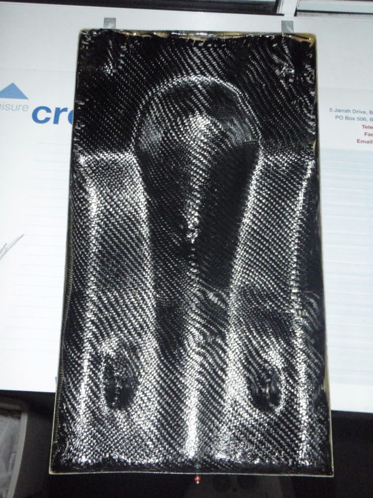

                      I laid some carbon cloth inside the hatch tonight, it was pretty flimsy so I thought it should help strengthen it and I also made a rear hatch lock using a push rod bolted to the hatch and the rod attached to the strut, I recon this will be good as it'll still be easy to tape and it holds the lid on very solid.
                      I'm wondering what a good cog would be good to start at, I'm guessing 29-30%, should that be a good starting point for the first run, I'm thinking that I might run 4sp2 with a x442 thats had the tongues removed, then once I get a feel I'll jump up to 6s2p with a m447/ x448 and maybe a x548??

                        a few pic's of the hatch and lock, I'll add floatation today. Can anyone offer any advise on how to close off the rudder water intake?? I'm not going to use it.

                          Nothing, just let water piss into the air heh heh
