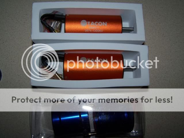

                Got motors in today!!!
                www.keithbradleyboats.com

                  Good looking motors, im really curious to see how they run............4 poles outta give you some real good power and cool temps.

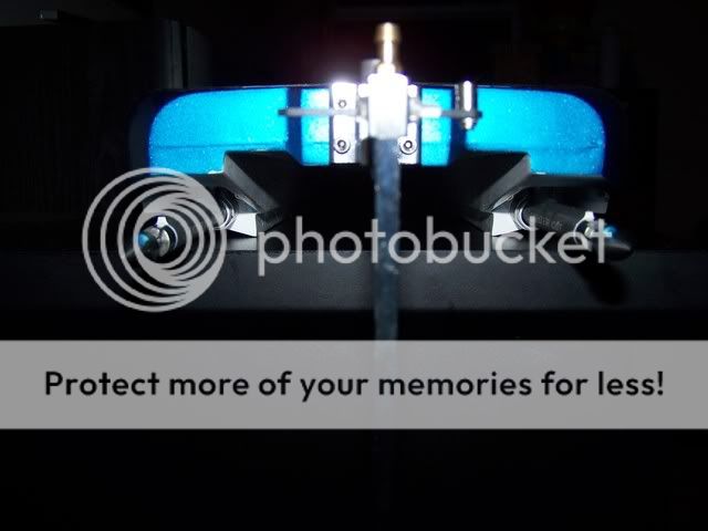

                    Let me know if there's anything I can do to help Jerry. I mounted the rudder and stingers...here's a look:

                              Those pics alone helped cuz i thought i was going to have to mount the stingers twisted alittle but i see yours are mounted straight up not turned,,,good now i no!!!wich motor mounts are you going to use, i got the big aluminum water cooled ones from the Fightercat store but when i set them in the hull i can easly get a cooling tube on one spout but the other is up under the edge and looks like theres no way to hook the tubing to it like im going to have to get a 90 gegree nipple to put on it,,

                                You wouldn't want the stingers anything other than straight up and down or they would toe out or in when you adjust them up and down.
                                I'm making my own motor mounts, similar to the ones I put in my EKOS build. It sounds like a 90 degree nipple will solve your problem.
