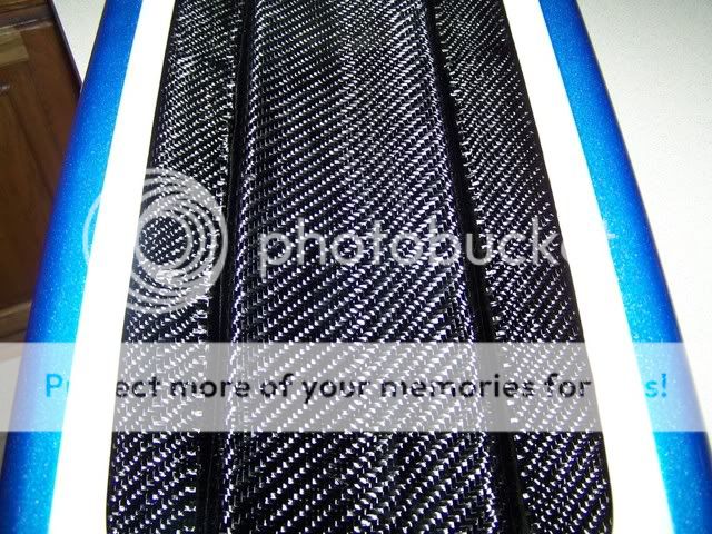

                        I got some carbon laid on the inside of the hull, double layered on the sponson transoms for extra support:

                          Keith CF makes for such a clean look, how is it applied and with what kind of resin??
                          • keithbradley
                            • 3663
                            I did a write up on it here:
                            That should help anyone looking to try out carbon fiber. Im not sure if you have to join that forum or not to follow the link...but try it and see. If it doesnt work its really easy to join.
