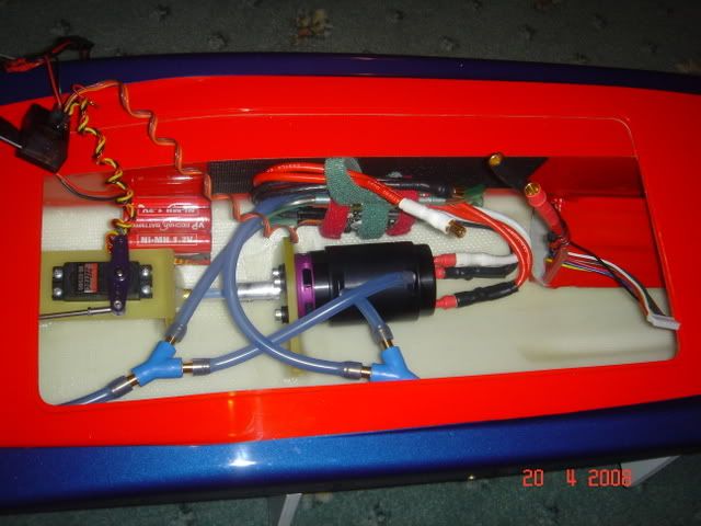

        Layout
        Here's how mine was laid out. The motor is now listed in the 'for sale section'.
        I ran it on 6s with a large K-series prop. 60+mph and very stable.
        I can't wait to get another. They are an awesome hull!!
          Too funny, I have your boat in the picture. Or should I say I have a second triton boat with the EXACT same paint job sitting in my garage. The insides are different. Hmm how is that possible? This explains why the finish is so nice, was your purchased with the paint scheme applied by the builder?.

            To show you, I just went out and took a few pics. Look.

              Yes, this finish is one of Joseph Toth's colour scheme's. It looks fantastic on the water!!
